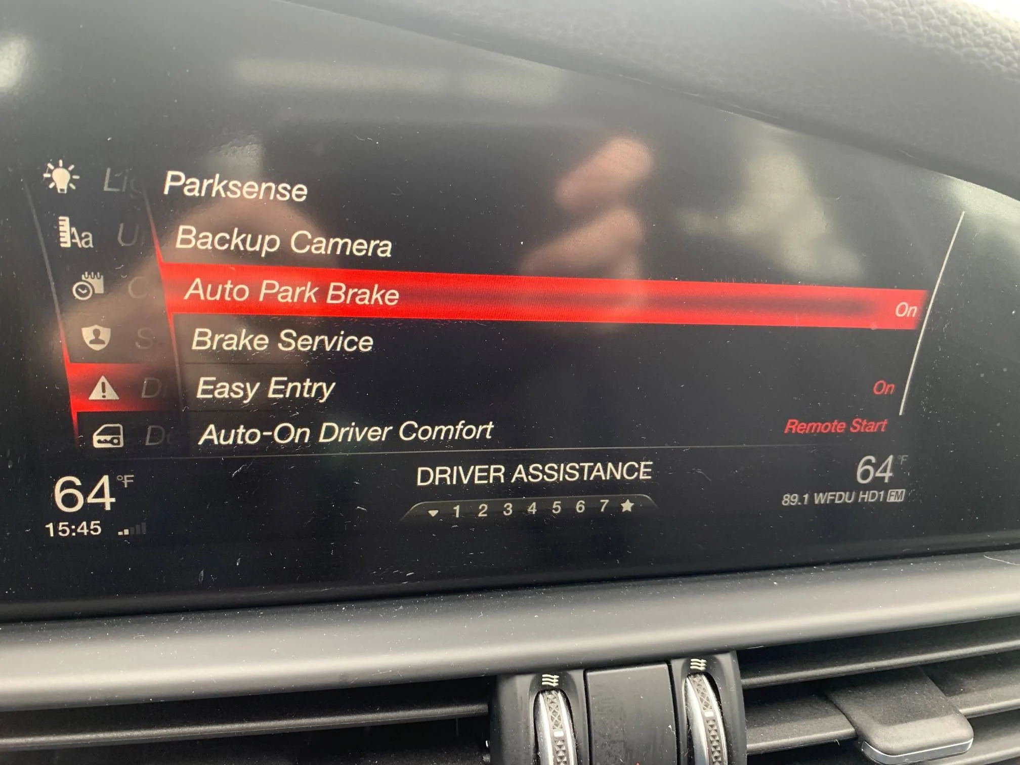

My concern is most European cars do this (well at least my Mercedes did and my Alfas do). I just have a feeling parking garage attendants are not going to know to do this.

Yours doesn’t engage automatically? I also have a 2022 Si and it engages when I take off my seatbelt when the car is stopped.
No, this is good to hear that is does, I just can't find the setting (I am assuming there is one, since I've seen most cars with electronic brakes do).
Really wish this had a manual parking brake...but I guess it's the way all the cars are going.
