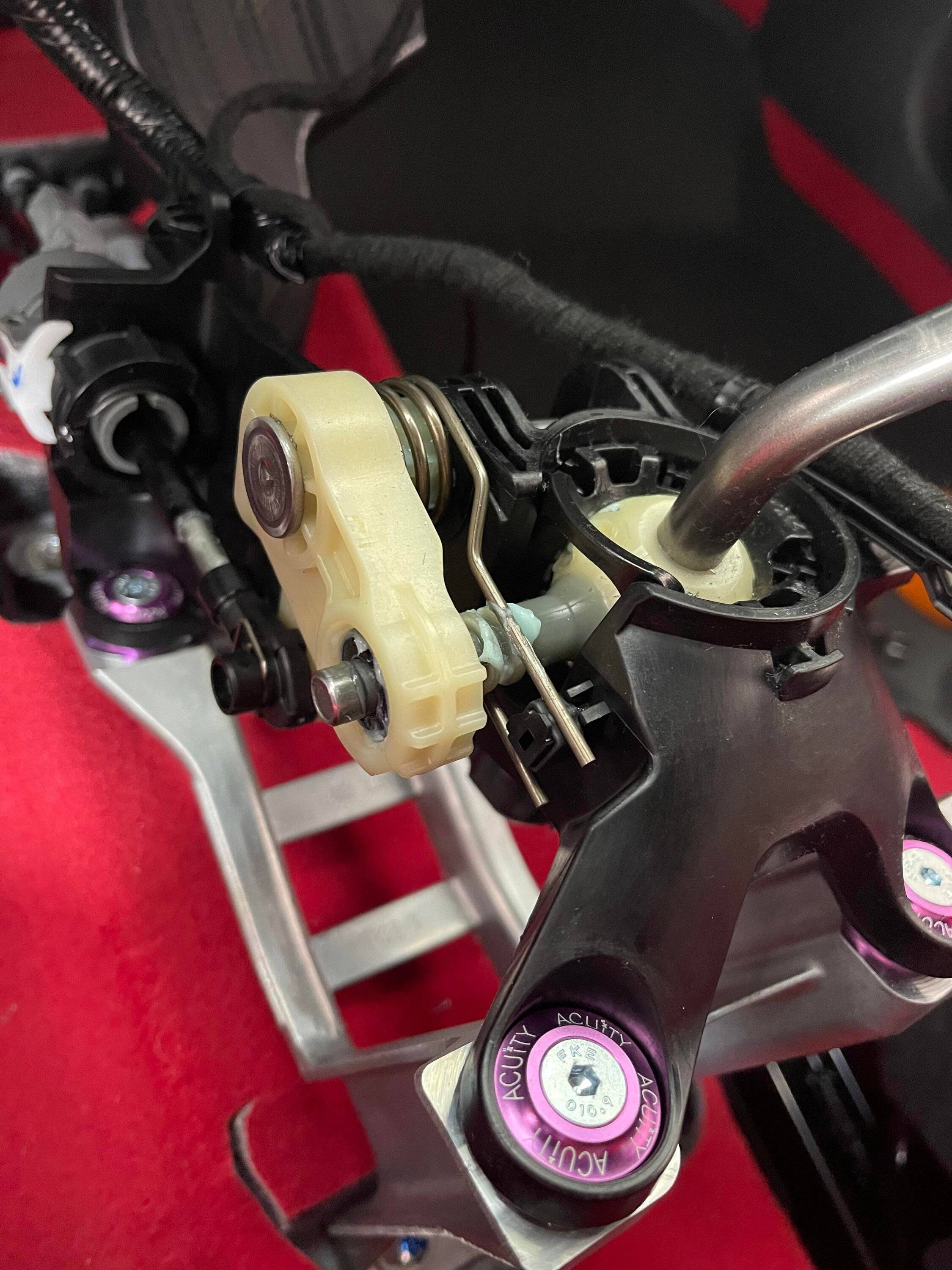

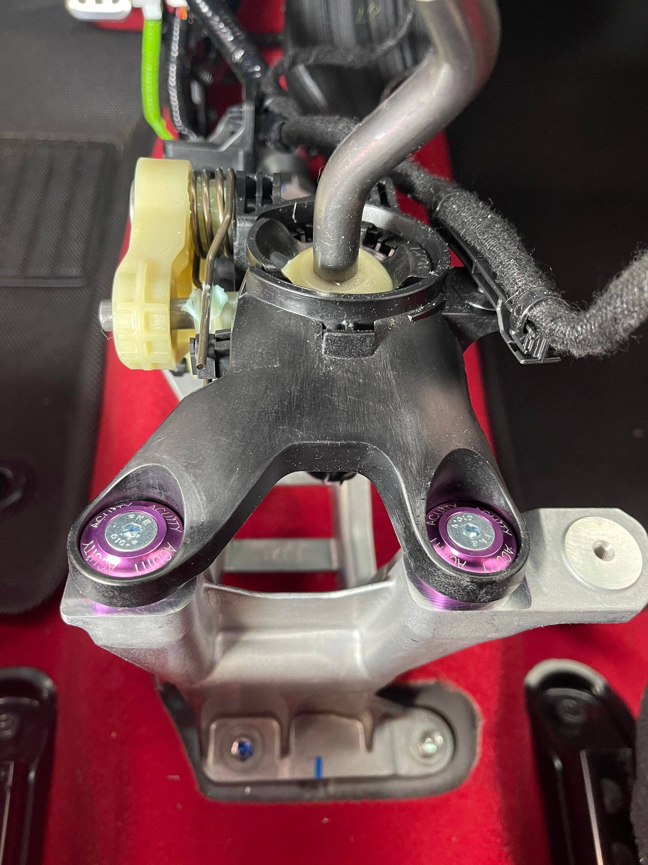

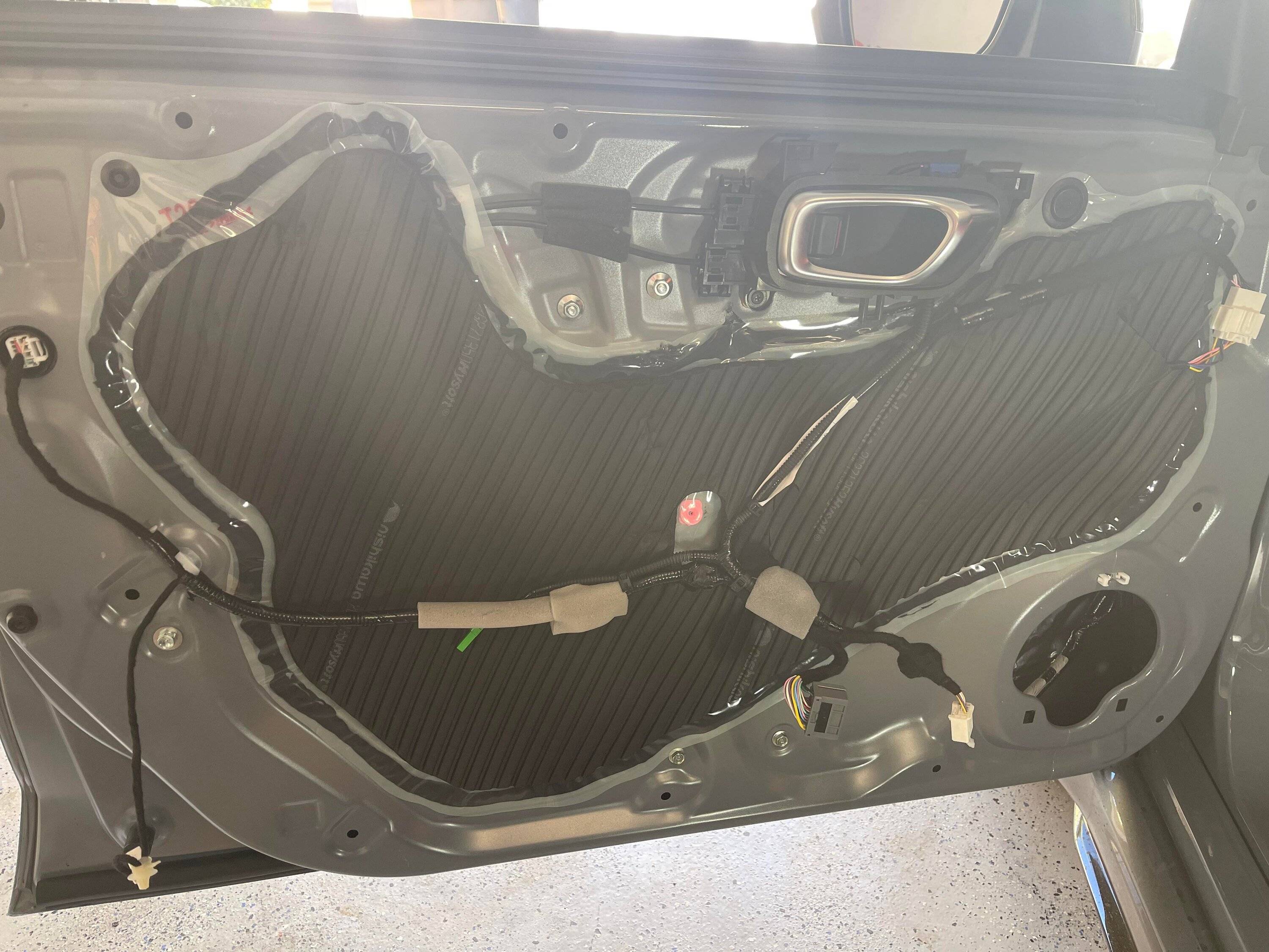

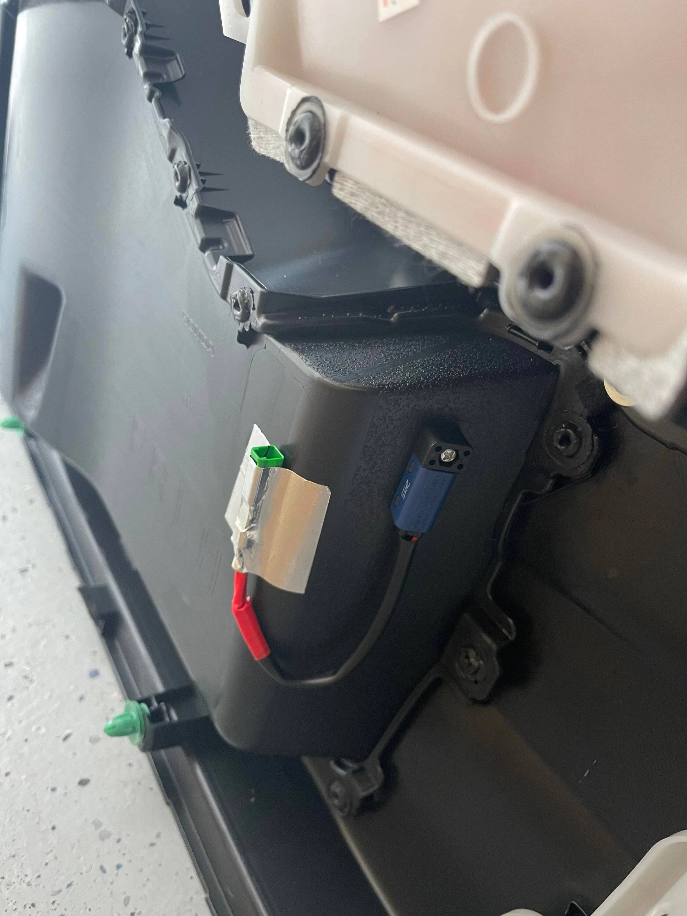

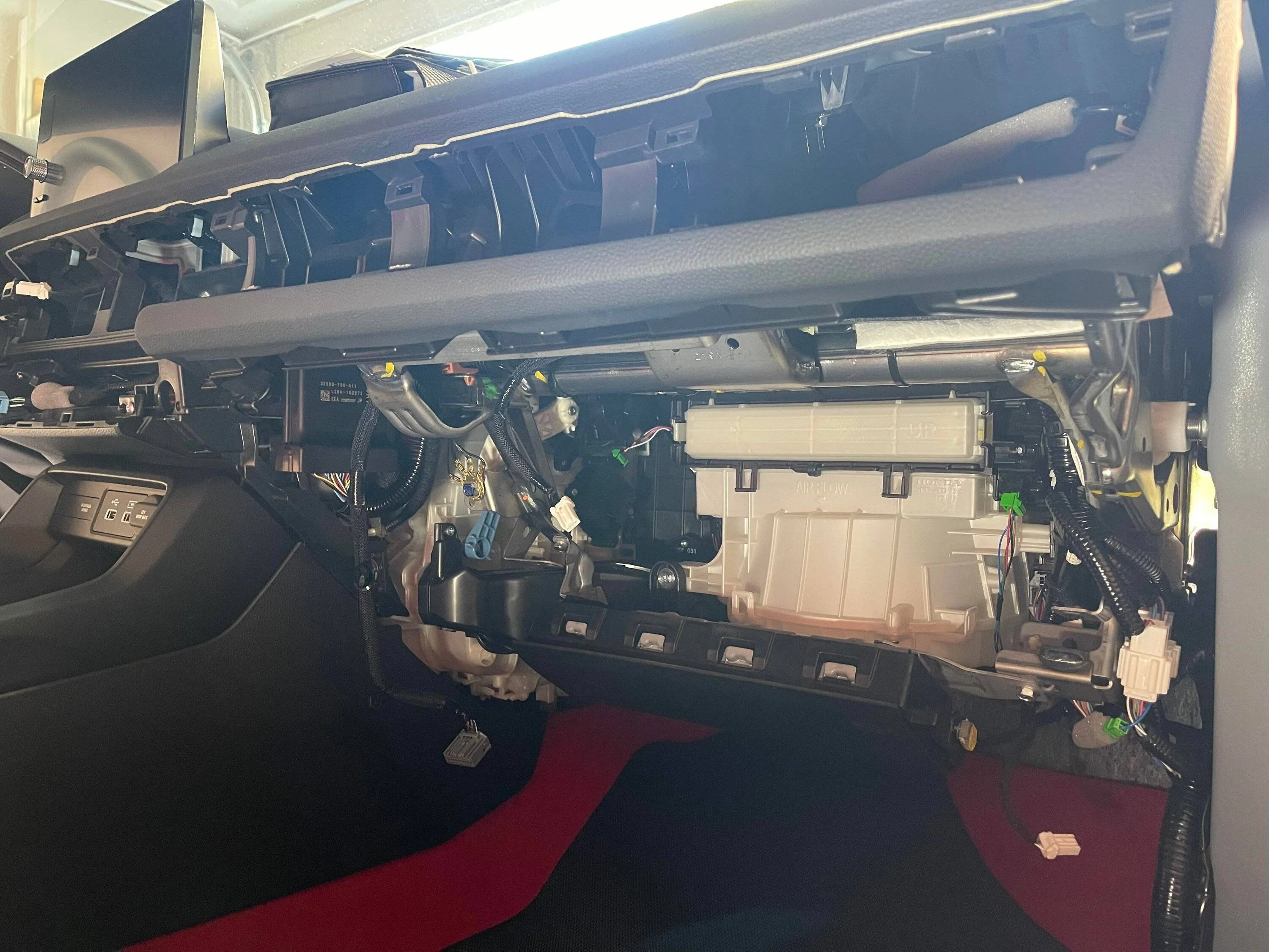

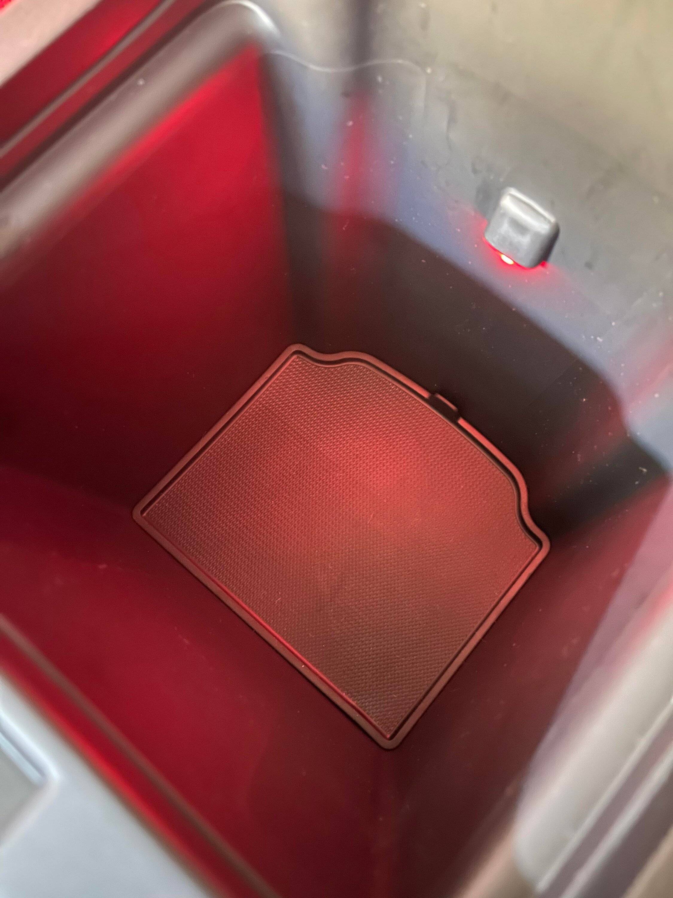

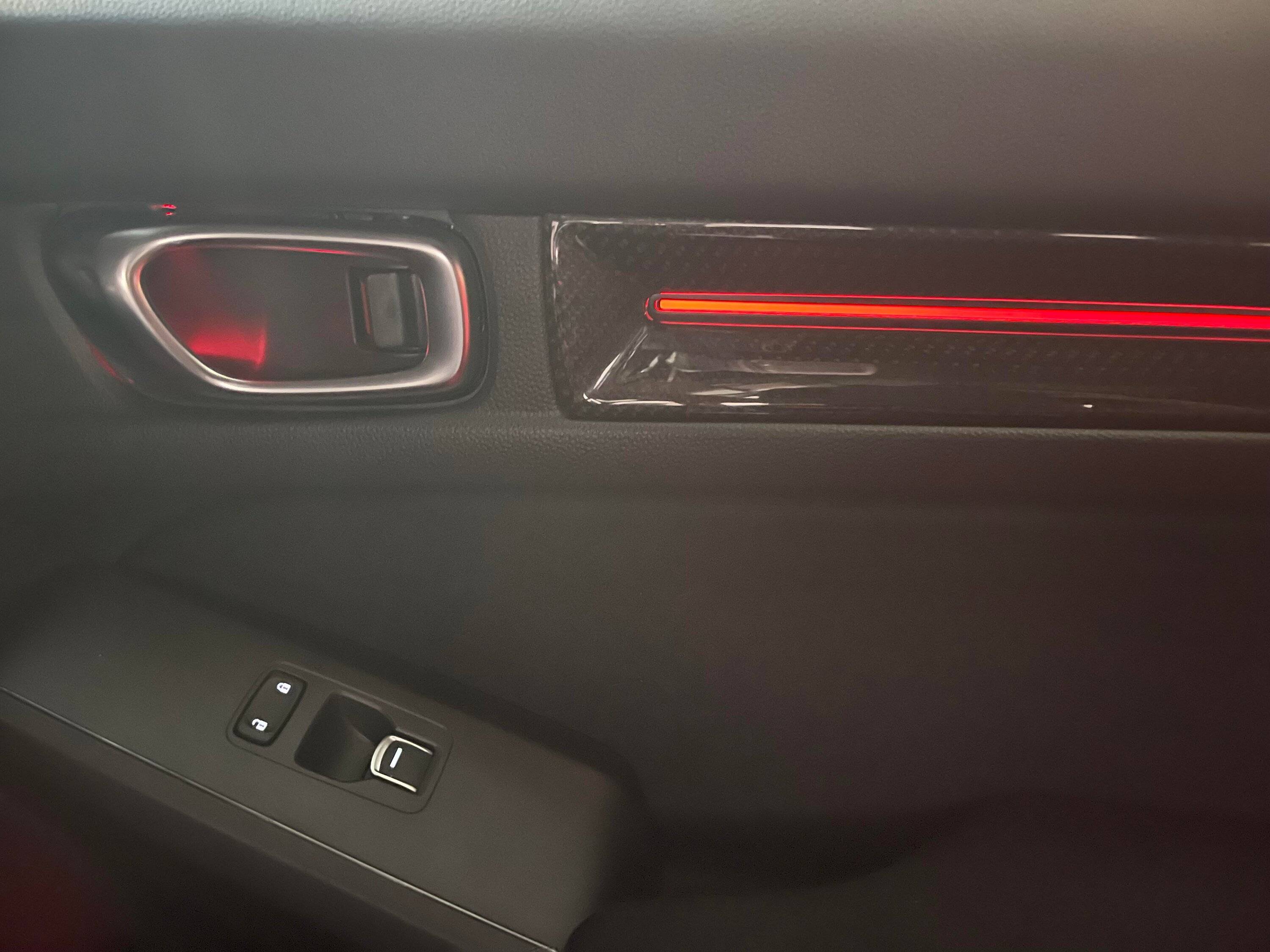

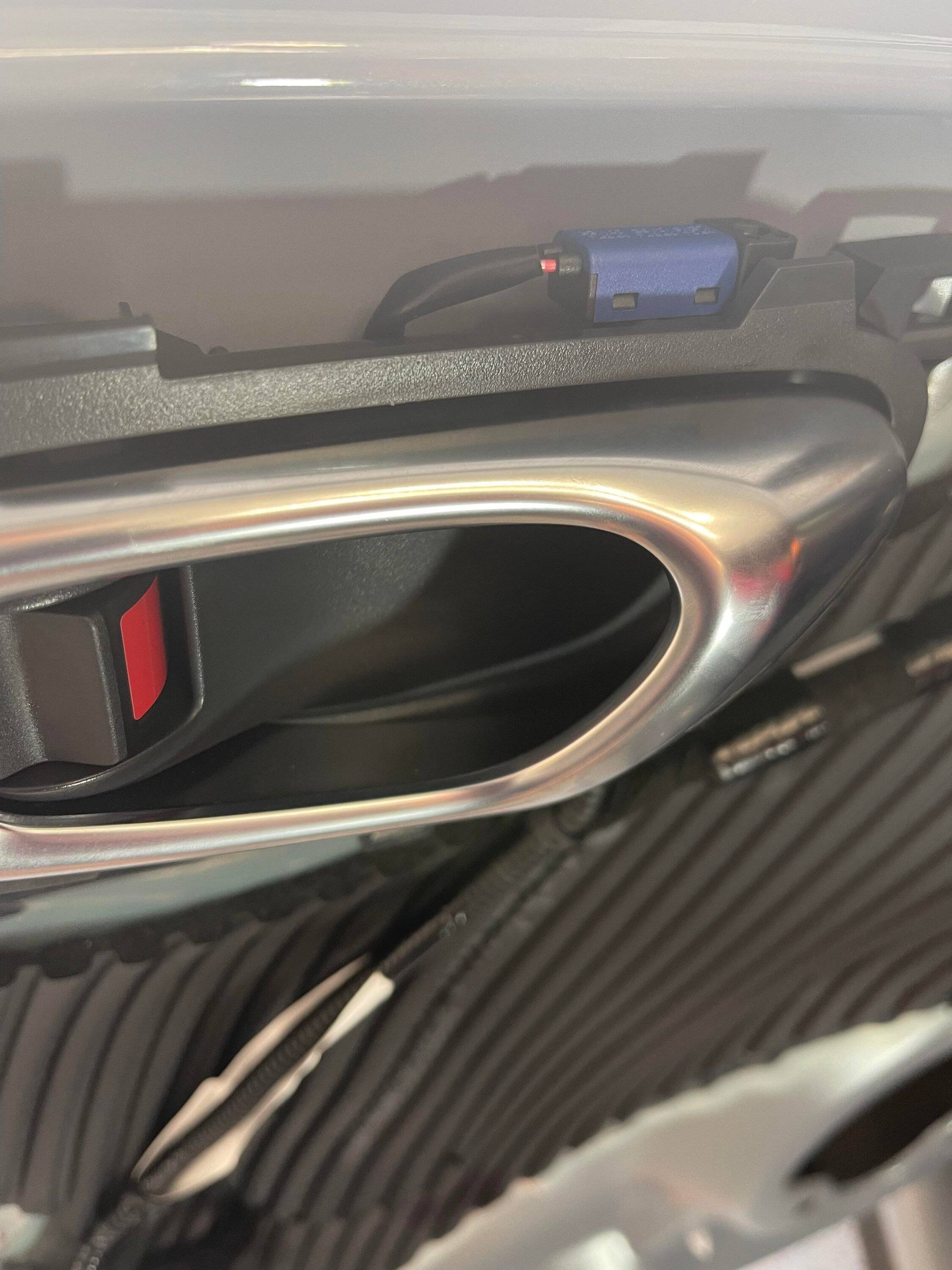

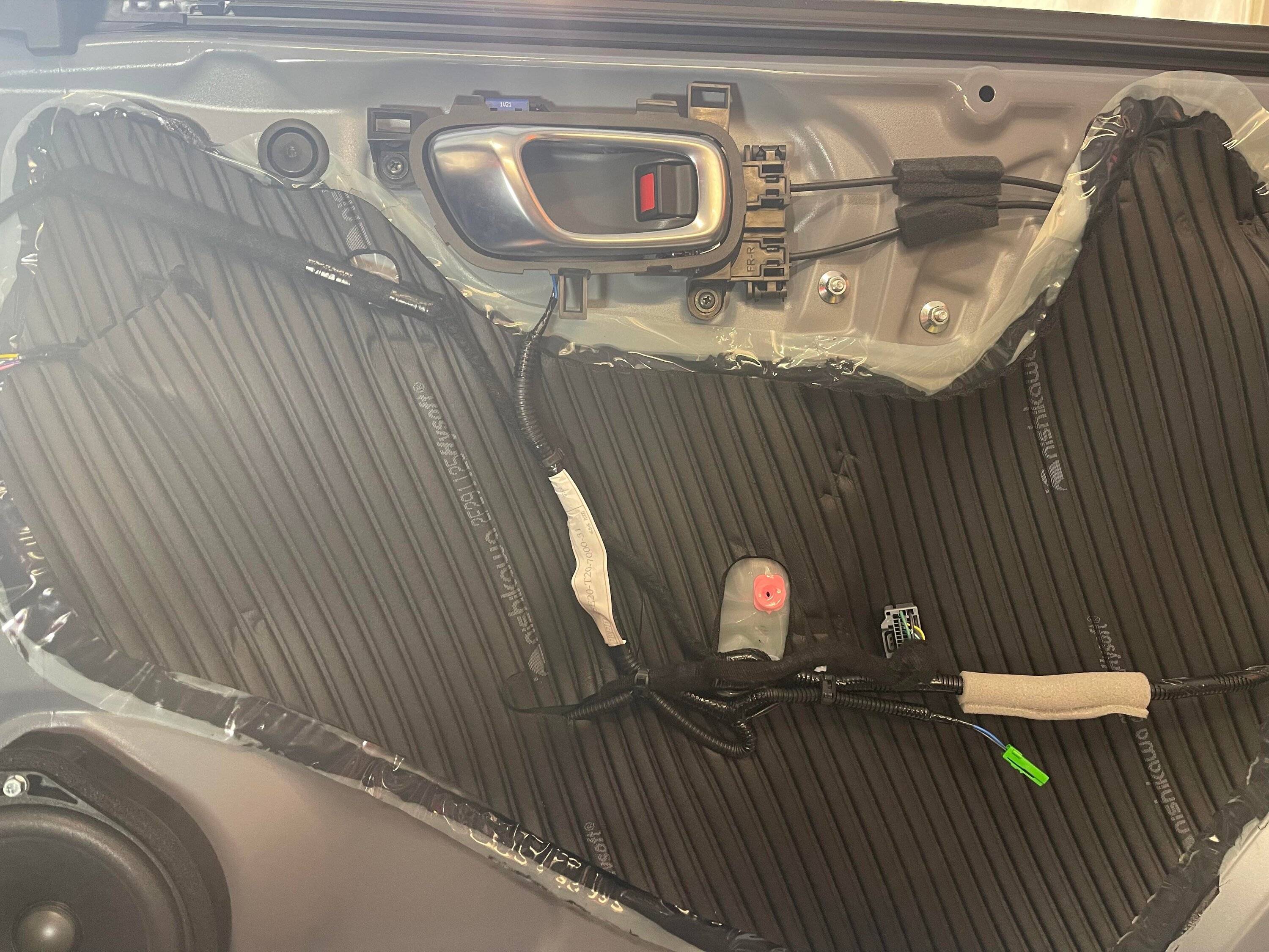

Spent the good part of the day installing the Honda Access LED light kit's on the doors and center console... turned out pretty nice :thumbsup: Now on the other hand install was a Pain in the Ass!! the wiring and finding the correct wires to tap into.. and while I was in there ripping everything apart .. I went ahead and installed some ACUITY Shifter base bushings for good measure they firmed up the feel of the shifter when feels great!.. needless to say it's not the install to take on if you don't have patience :banghead::rofl:
Anyways here are some pic's and if any of you try to install this in the future I'll be glad to answer any questions you might have:wave:

11th Gen Honda Civic JDM Honda Access Interior LED Door Lights and Center Console Lights installed. Acuity FL5 Shifter Base bushing install 1
11th Gen Honda Civic JDM Honda Access Interior LED Door Lights and Center Console Lights installed. Acuity FL5 Shifter Base bushing install 2

Right on for hooking it up :thumbsup:
I did it for my FK8 and the hardest part is feeding the harness thru the door accordion ... that was painful :confused1: I might do this again. :hmm:

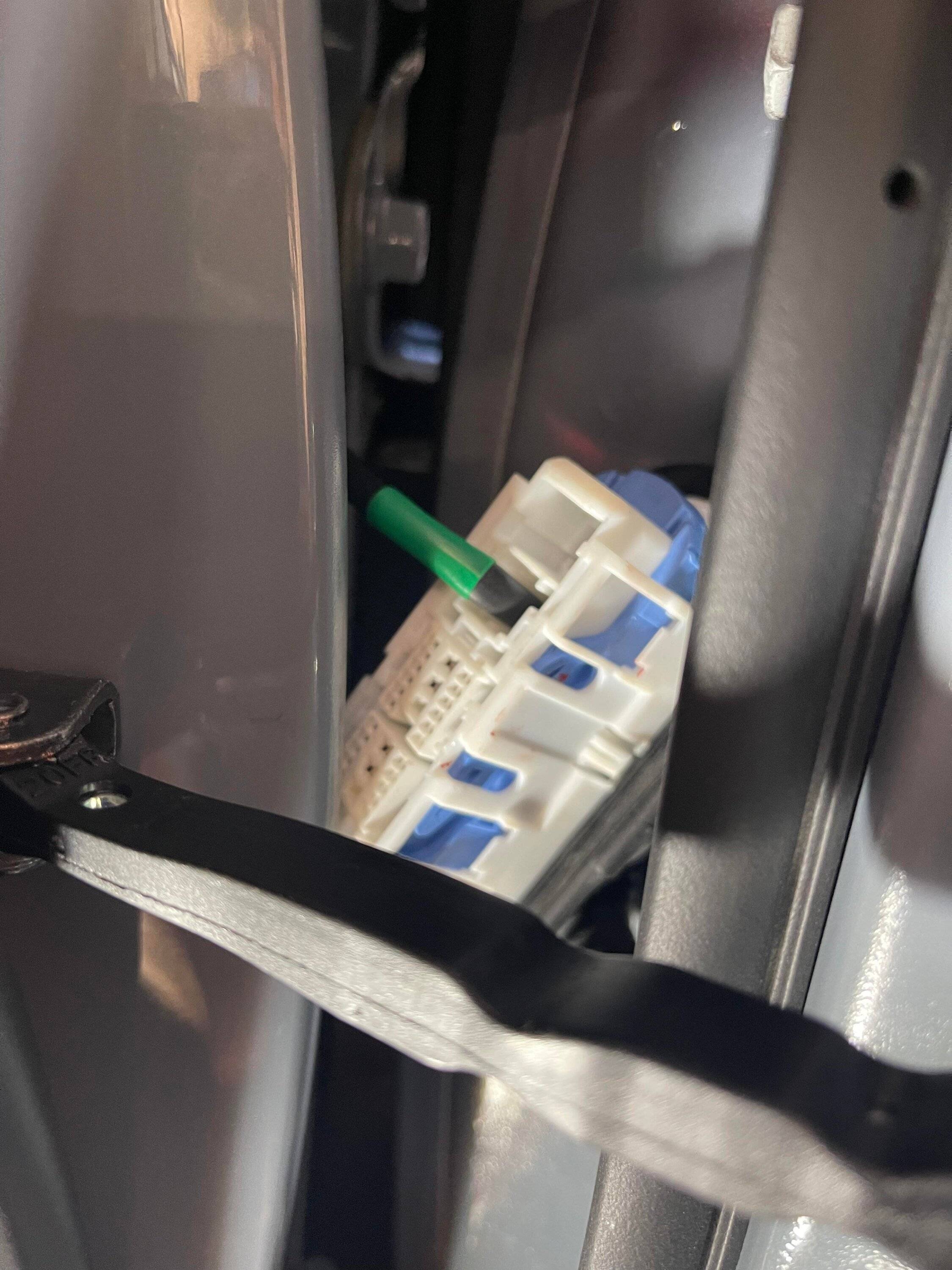

Right on! you nailed it…the door plug was the biggest pain :confused1: it was easier on the 10th gen for sure… as you can see in the pictures I removed everything I could minus the airbag to get access to the connector to make it as painless as possible… that connector is bitch to say the least.. it has 4 half assed retaining clips on the outside under the rubber boot and once those are released it’s pretty straight forward .. then you release the upper blue clip to unset the harness:coffee:
