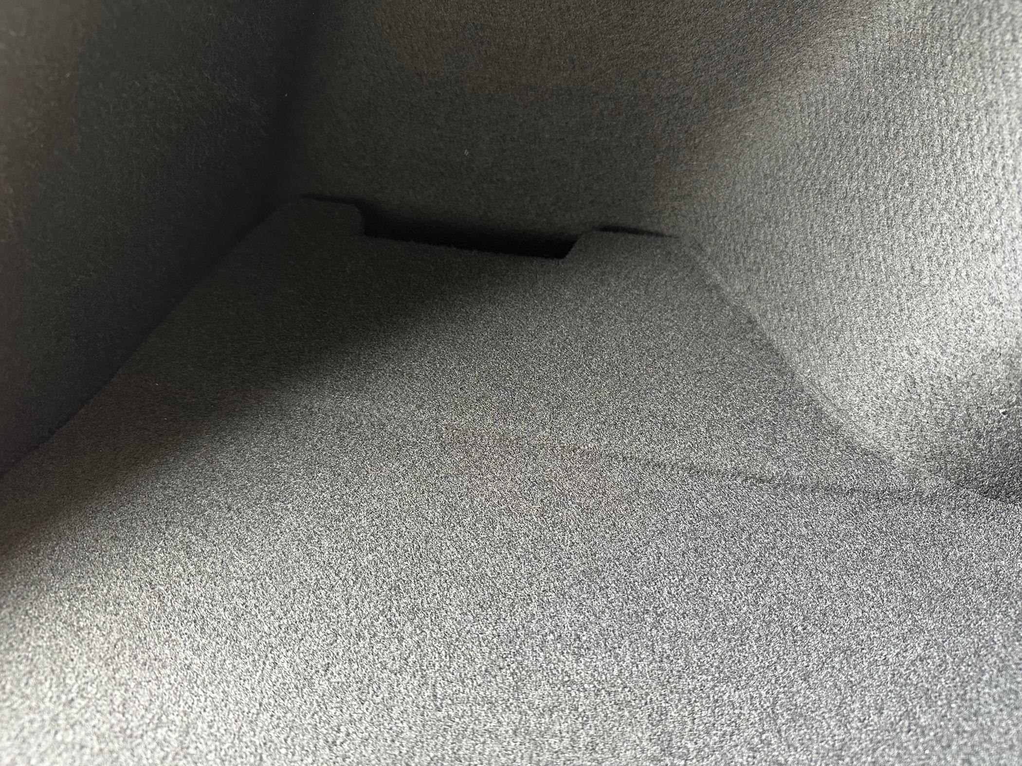

Fitment is perfect:
11th Gen Honda Civic [Install Guide] Installing aFK8 spare tire and full kit in the FL5 IMG_3842

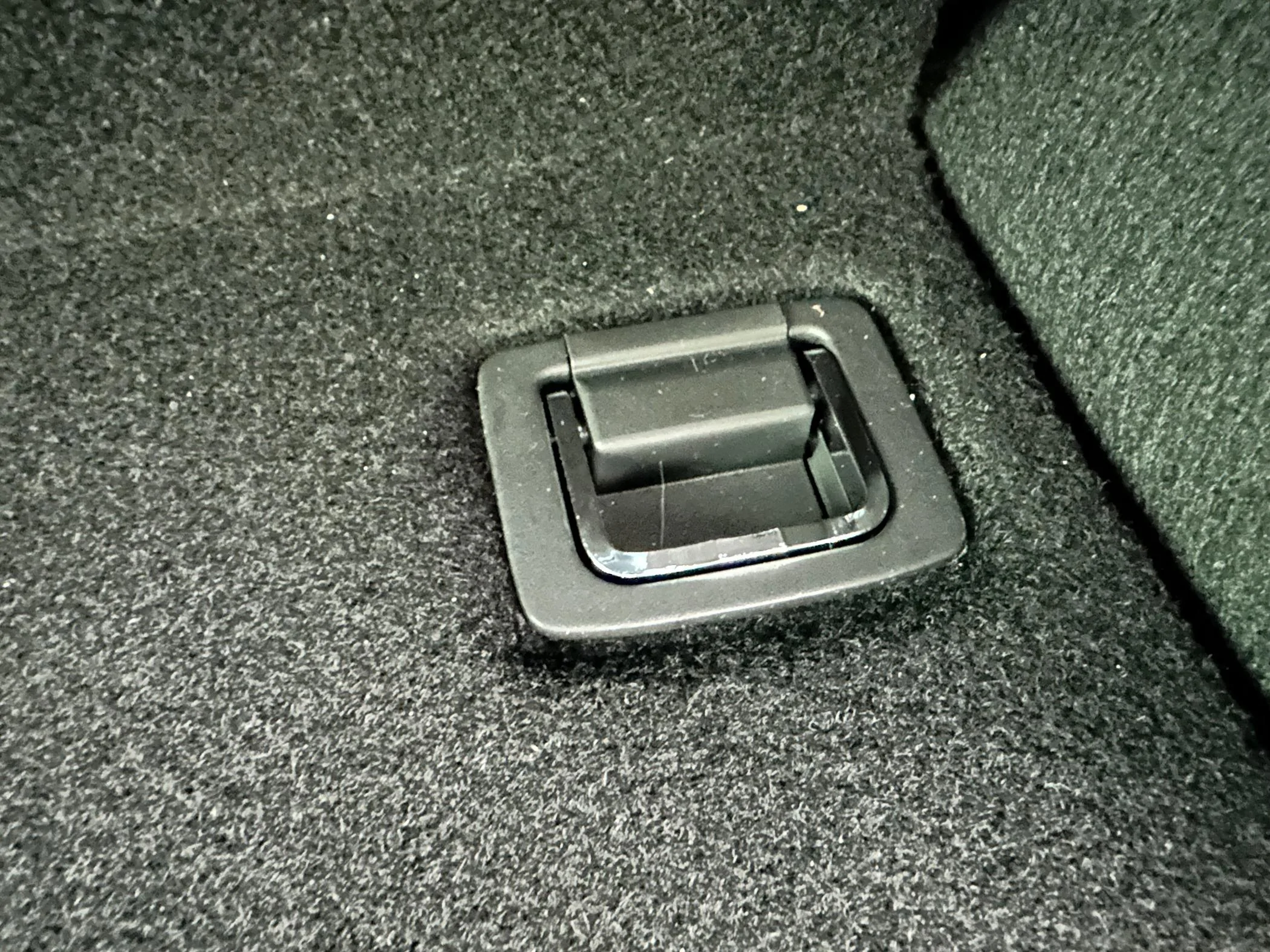

Open your rear passenger doors and fold the seat backs down. Locate the two metal tie down points:
11th Gen Honda Civic [Install Guide] Installing aFK8 spare tire and full kit in the FL5 IMG_3840
Flip up the metal portion, then use your pry tool to pry up the inside plastic piece. There are tiny indentations you can insert the pry tool into as shown in the photo below:
11th Gen Honda Civic [Install Guide] Installing aFK8 spare tire and full kit in the FL5 IMG_3844
After prying that up, use a Philips screwdriver and remove the screw within.
You can then remove the tie down piece by gently pulling up. Repeat on the other side, then set these pieces aside as they will be reused later.
