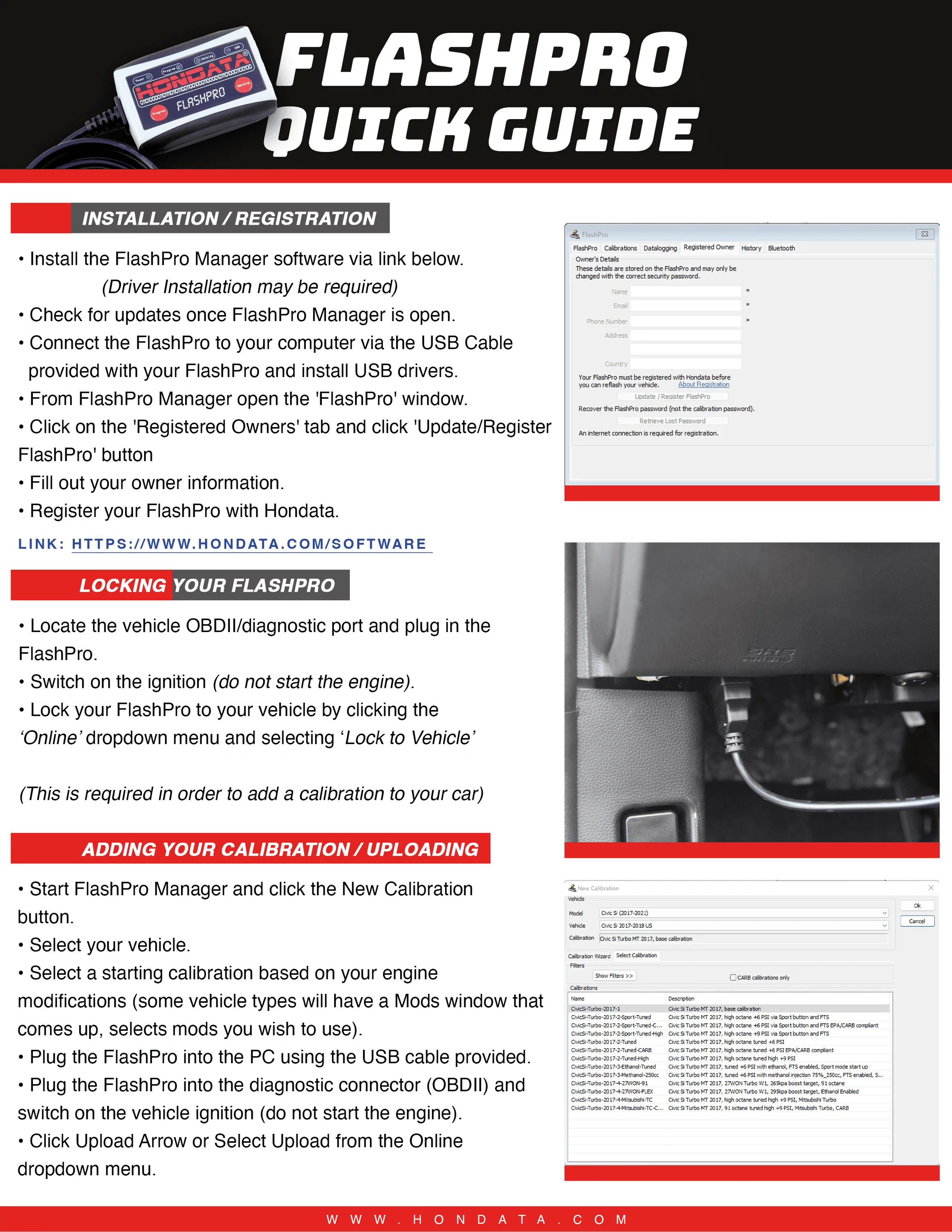

Quick Start Guide
The 2022+ US Civic 1.5 FlashPro allows advanced datalogging and tuning capabilities. Combined with thoroughly tested preset calibrations, our FlashPro systems allow you to gain more performance from your new turbo Honda Civic.
STEP 1: INSTALLATION / REGISTRATION (Internet connection is required)
• Install the FlashPro Manager software via link below.
(Driver Installation may be required)
• Check for updates once FlashPro Manager is open.
• Connect the FlashPro to your computer via the USB Cable
provided with your FlashPro and install USB drivers.
• From FlashPro Manager open the 'FlashPro' window.
• Click on the 'Registered Owners' tab and click 'Update/Register FlashPro' button
• Fill out your owner information.
• Register your FlashPro with Hondata.
LINK: HTTPS://WWW.HONDATA.COM/SOFTWARE
STEP 2: LOCKING YOUR FLASHPRO
• Locate the vehicle OBDII/diagnostic port and plug in the
FlashPro.
• Switch on the ignition (do not start the engine).
• Lock your FlashPro to your vehicle by clicking the
'Online' dropdown menu and selecting "Lock to Vehicle"
(This is required in order to add a calibration to your car)
STEP 3: ADDING YOUR CALIBRATION / UPLOADING
• Start FlashProManager and click the New Calibration
button.
• Select your vehicle.
• Select a starting calibration based on your engine
modifications (some vehicle types will have a Mods window that
comes up, selects mods you wish to use).
• Plug the FlashPro into the PC using the USB cord provided.
• Plug the FlashPro into the diagnostic connector (OBDII) and
switch on the vehicle ignition (do not start the engine).
• Click Upload Arrow or Select Upload from the Online
dropbox menu.
Enjoy & Stay Tuned!
Feel free to save this PDF for future reference or share it with someone who needs it.
