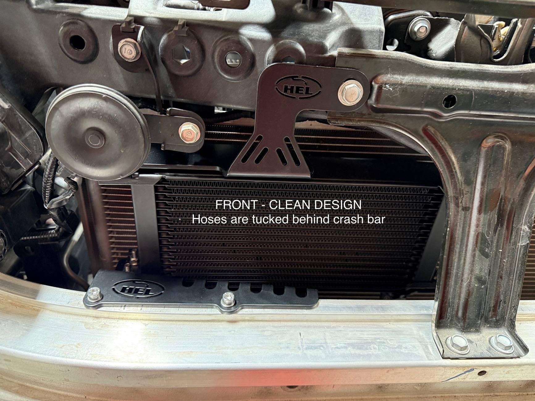

- The kit has great quality of parts
- IMO the design of the hose routing creates reliability risks (hoses rubbing on things that are sharp) I would not be comfortable with on a daily driver (without modification). On a track only car you probably have the bumper off enough to monitor wear and tear.

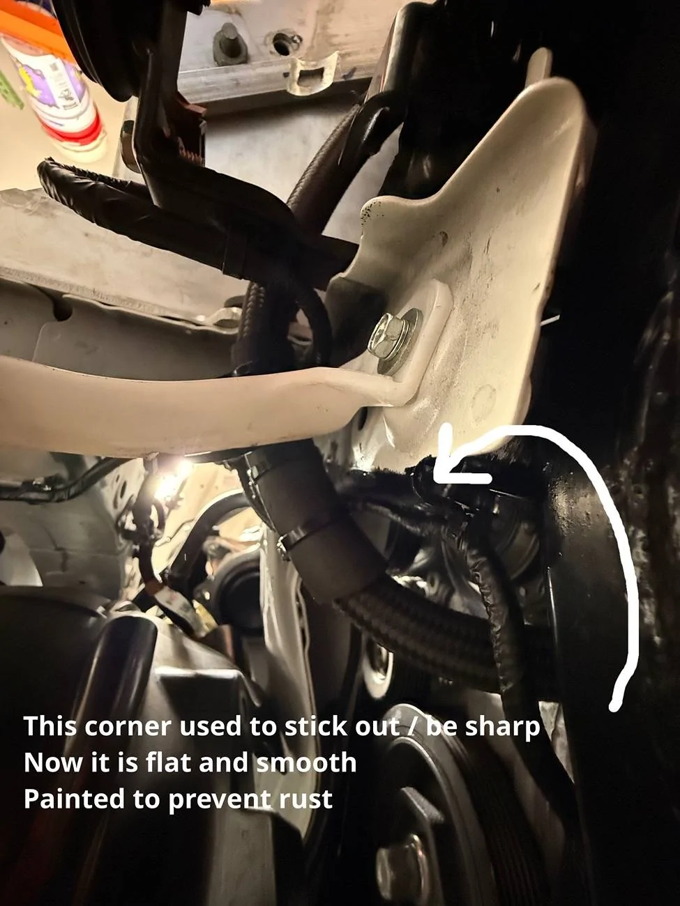

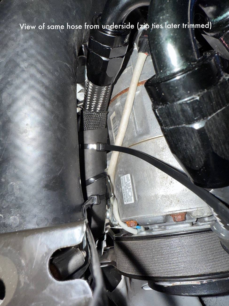

- In general the hoses run VERY close to the belt and a number of sharp edges. I used a split hose and zip ties to avoid rubbing wherever I could. Keep in mind when ziptying the hoses to the body, AC compressor, etc. the motor rocks under load so you need to ensure the hoses can move with it.
- You need yo be very precise about the positioning of the oil pedestal and the hard lines coming out of it to minimize the likelihood of rubbing/ cutting a line.

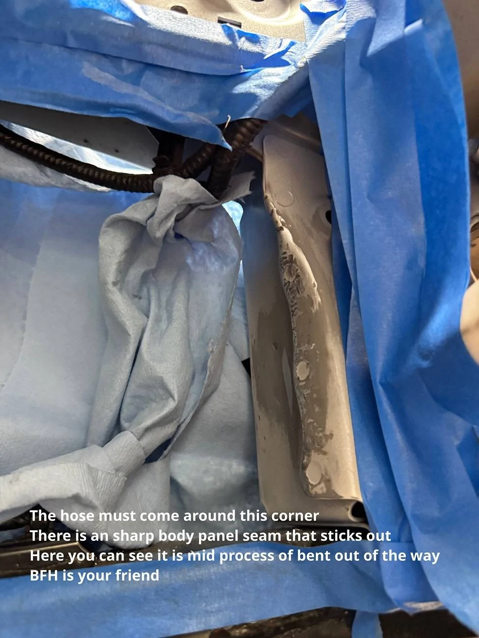

- There is one corner (where a body seam sticks out in a sharp wdge by about an inch. The hose is pulled against it when the motor is under load. That seems very likely to be a problem. That is the one in the photos where 30 minutes with the BFH convinced the body seam to be a nice round curve instead of a straight edge ?. Remember to paint it afterwards to avoid rust.
