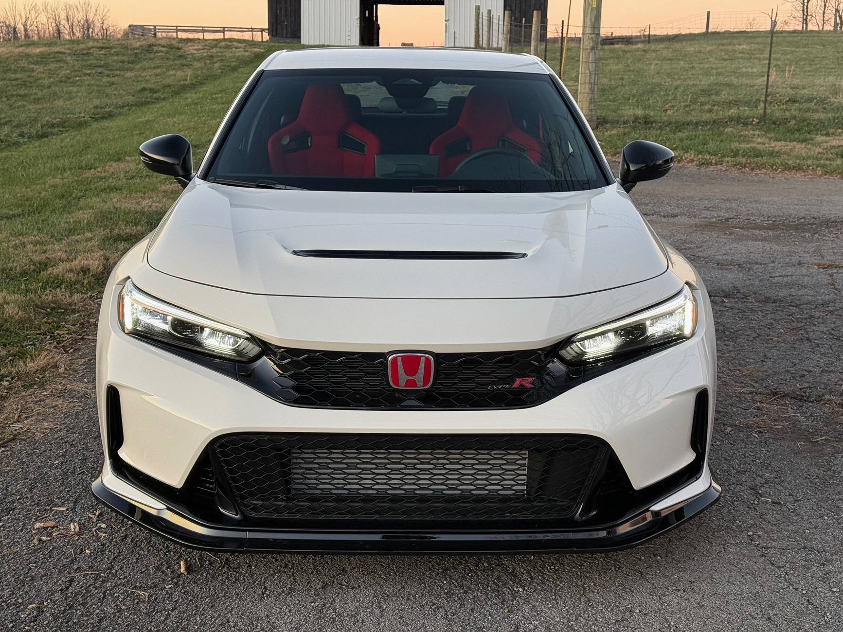

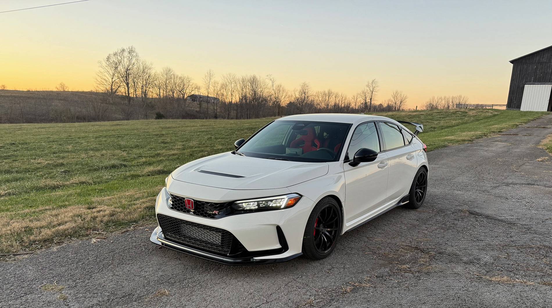

I got the car in November of 2024, right off the showroom floor. I felt very fortunate to only pay MSRP and not a penny more. Fast forward to the beginning of December and I put on new wheels and tires and lowering springs. I also put on my front lip! The only engine mod at this point is an oil catch can to preserve the engine until I start the next phase. Attached are some pictures of the current progress.

11th Gen Honda Civic GoSailin - Type R Build Journal new wheel setup 2
11th Gen Honda Civic GoSailin - Type R Build Journal Type R lip install 2
11th Gen Honda Civic GoSailin - Type R Build Journal Type R Front lip install
