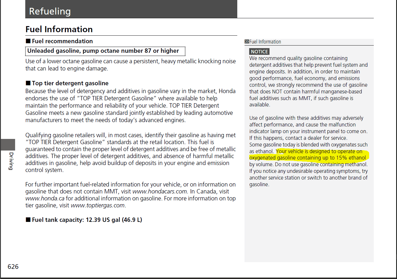

I have a 2022 Sport, and am curious
With the rising gas prices, Can I use the Unleaded 88 fuel? It’s much cheaper than 87 and it says it good for 2001 and newer cars, but y’all know more than I do.
Also, what kind of fuel do y’all use and do y’all se any sort of difference?

I think that has 15% Ethanol which I think is too much for what the civic is rated for.
Looks like you can.
11th Gen Honda Civic Fuel Types 1645502094443
Looks like you can.
So I saw that the 88 is up to 15%, so since it’s a octane higher that 87 and the manual says up to 15% as well It should be fine right?
Would save me like nearly 40¢ a gallon ??
