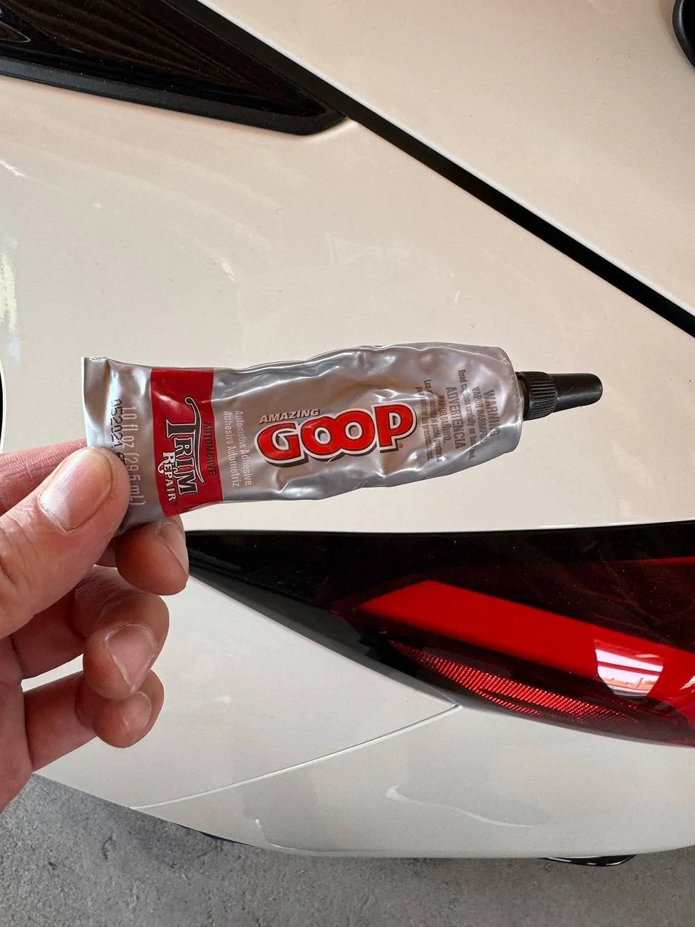

-Goop trim glue

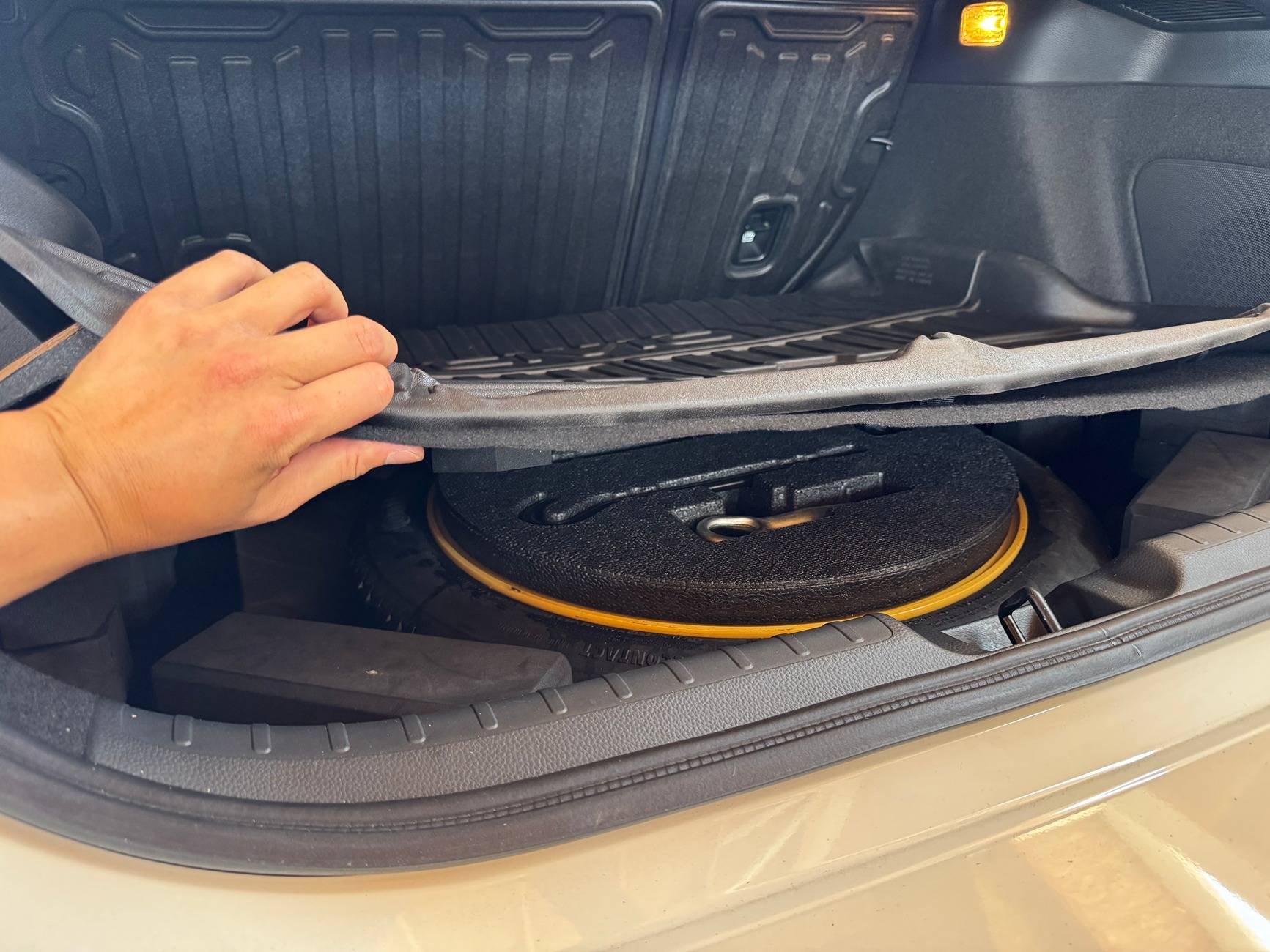

Step 1 - Remove your FL5 Tray cover and replace it with the new FK8 tray cover. Two screws under a cover at the holes
Step 2 - Remove your privacy retracting screen from the trunk

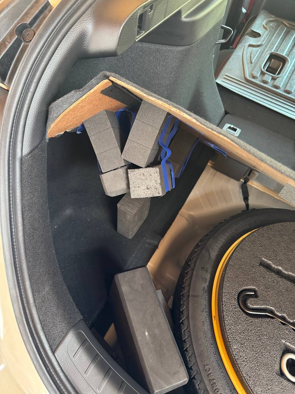

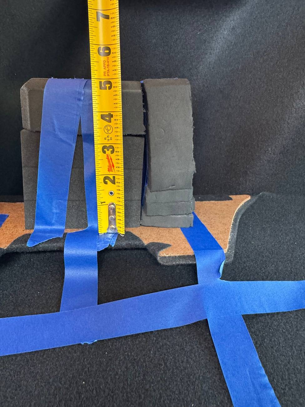

Step 3 - Cut your 2" yoga block using your serrated knife. You want to cut enough to add to the green areas in the first picture. It should boost each block to at least 5" in total. I wouldn't worry too much about how it looks, it will all be covered in the end. Add 2 strips of masking tape to test fit all the pieces. Adjust as needed.
>>Green indicates the need to add material to boost to 5"
>>Red indicates the need to create your own stack/block to support the added gap
>>Blue indicates an area where you can wedge the large Yoga blocks without modification
Step 4 - This is an optional but recommended step, create your own stack of blocks or a solid block to fill in the red squared areas. These are stress points that are empty and would benefit with support, otherwise you will feel like the board has gaps that can cave in.

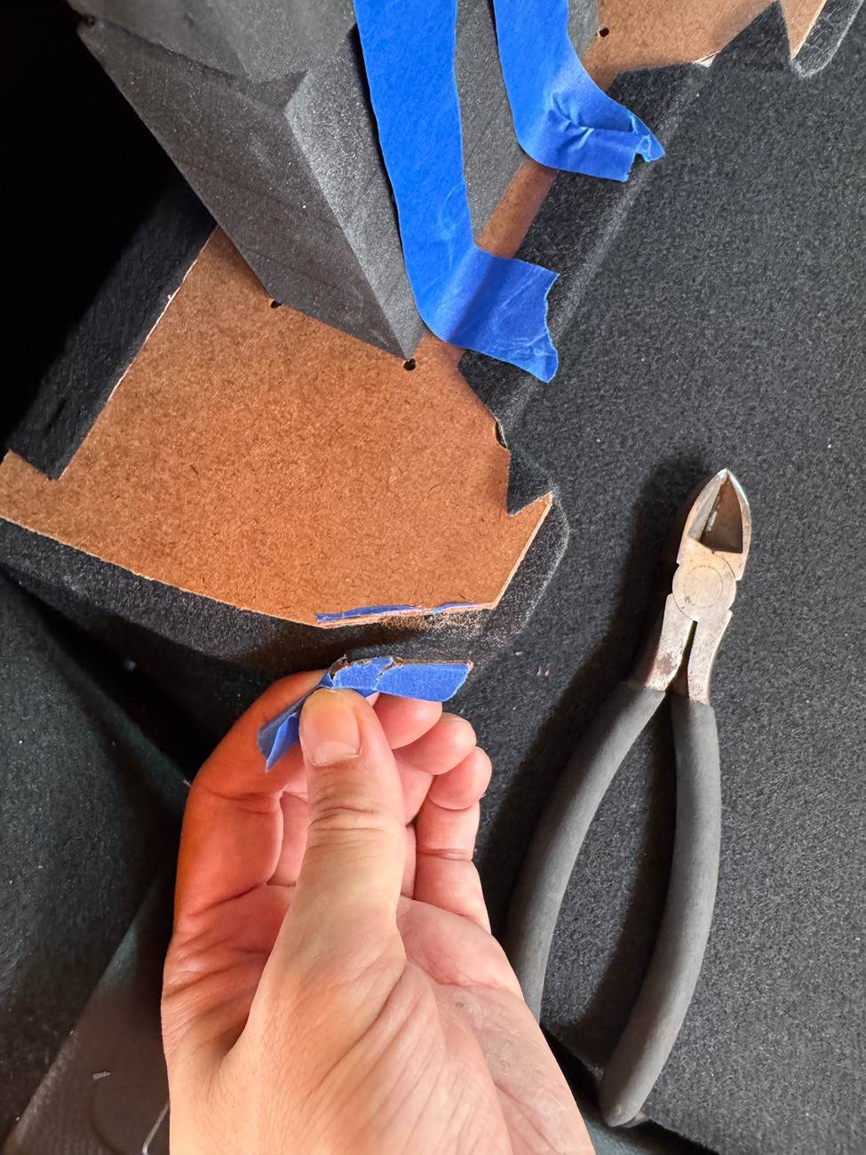

Step 5 - Cut down the left flap board with wire cutters, use the adhesive side of masking or tape to pick up the dirt and debris
Step 6 - After test fitting the board and you are satisfied, remove and add 'Goop' to each addition. I used the same masking tape to hold it in place along with closing the board down so that it all stays in place. Give it time to dry.

The result is a nice flat surface right from the trunk lock with the same benefit of the trunk tray mat. If you prefer to run it without the mat, it looks even better. My car is a daily, so I do not mind how this looks and would prefer coverage from dust and accidental spills.

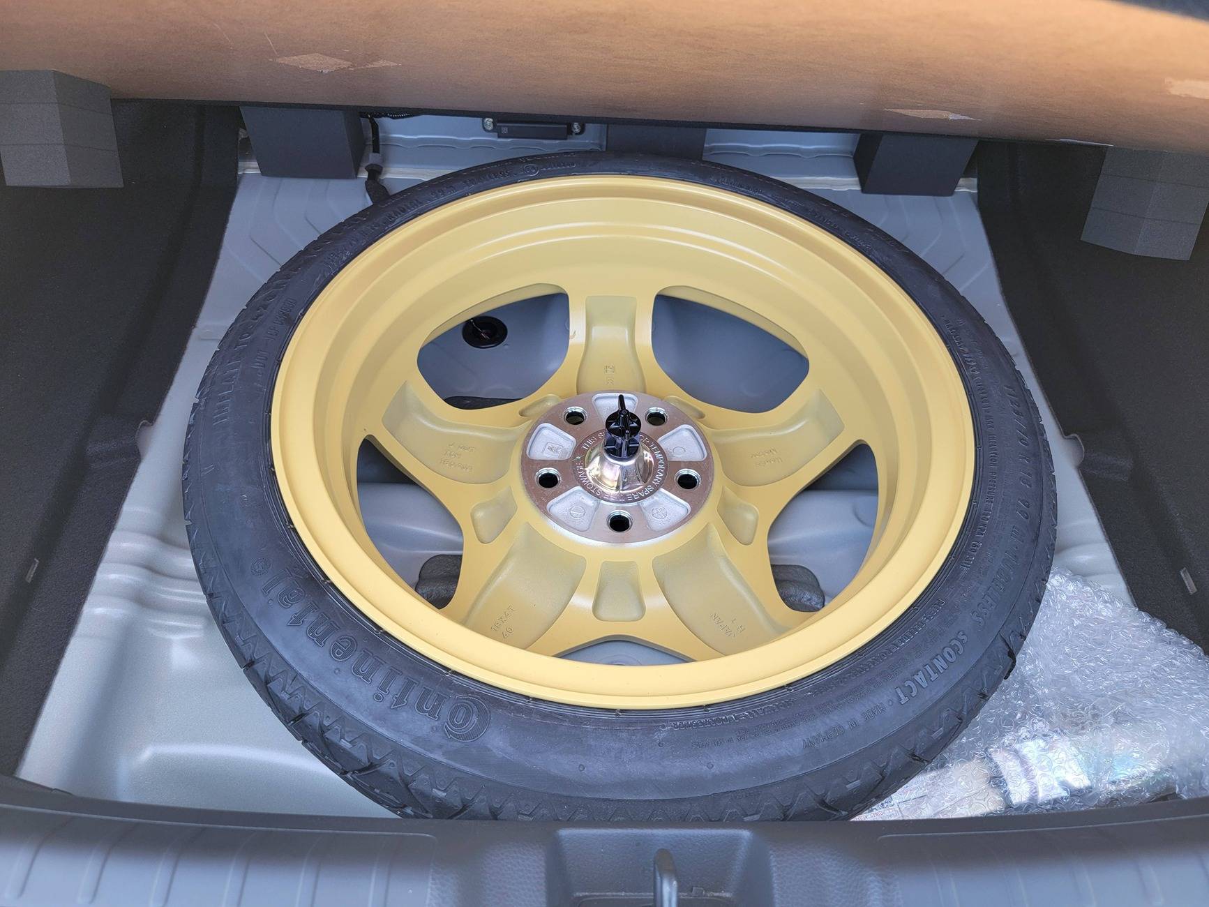

This is our only inexpensive option for the spare tire swap. I bought the fk8 spare kit and paid 350 otd with the tire at my local honda. I would advise calling around these dealers will tax you.
