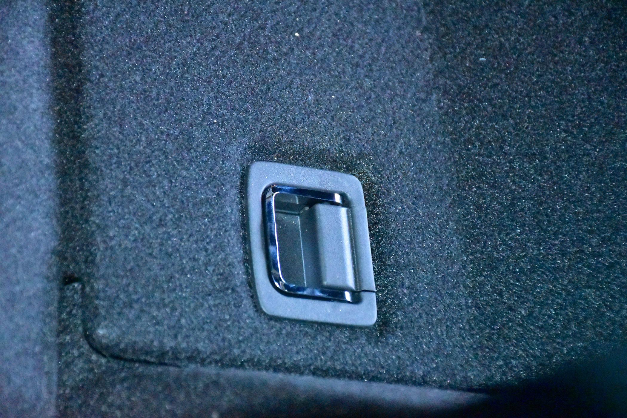

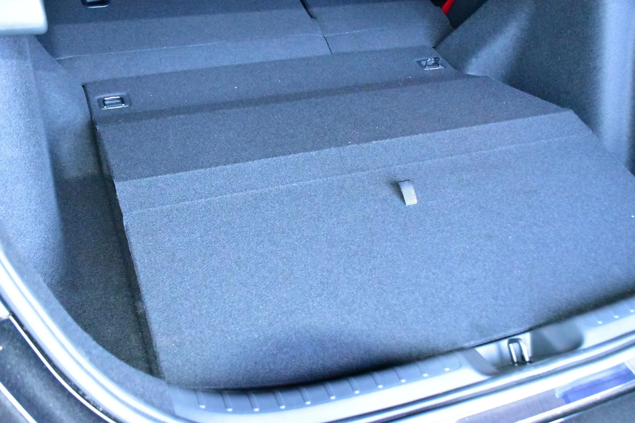

Zone47 Senior Member First Name Joe Joined Mar 8, 2024 Threads 19 Messages 295 Reaction score 255 Location NE Ohio Vehicle(s) FL5 Civic type R, MK7 GTI, Toyota 4x4 Apr 9, 2024 Thread starter #1 .... so I can remove the rear carpet and folding panels?
HRace Senior Member Joined Feb 24, 2018 Threads 2 Messages 341 Reaction score 21 Location United States Vehicle(s) Honda Civic Apr 9, 2024 #2 I thought the center plastic piece is a hinged cover covering a bolt underneath. Small pry tool should get the center plastic to pop open and then a screw to remove l and you should be good.
OP OP Zone47 Senior Member First Name Joe Joined Mar 8, 2024 Threads 19 Messages 295 Reaction score 255 Location NE Ohio Vehicle(s) FL5 Civic type R, MK7 GTI, Toyota 4x4 Apr 9, 2024 Thread starter #3 Thanks... yeah that was too easy. I always break these fasteners and then realize how easy it would have been to do it the right way. Sponsored
