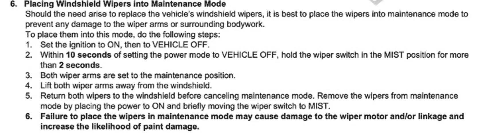

Also there is a maintenance mode for the wipers to move them up so you don't hit the hood.
