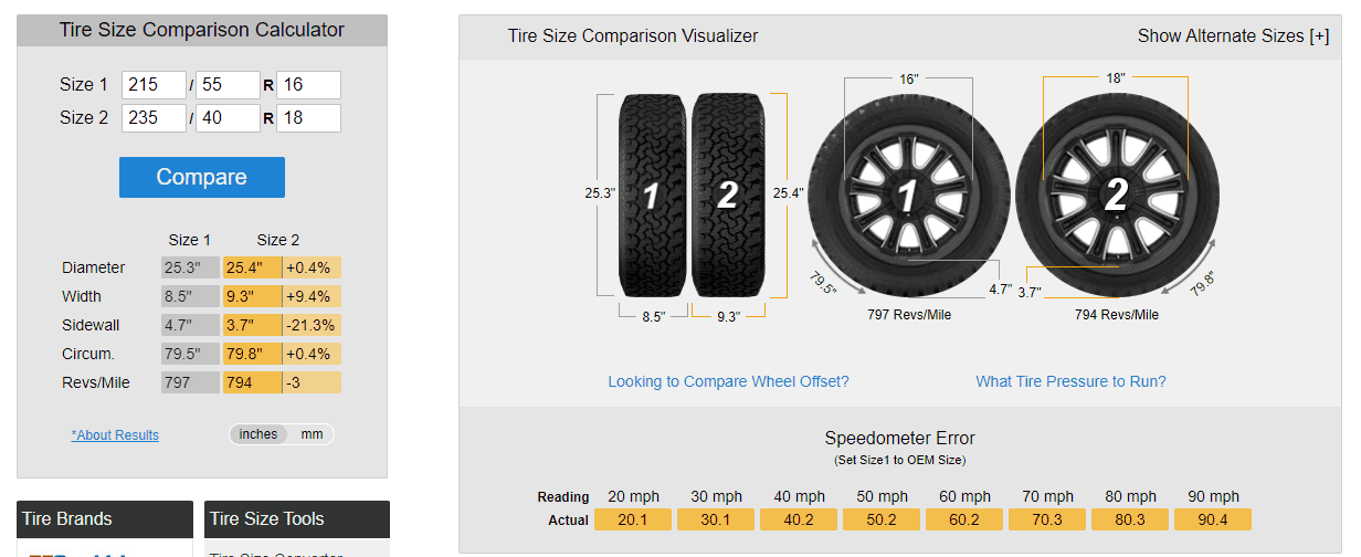

Should be no problem. The overall outer diameter is the biggest concern. TPS won't be an issues since Civics use wheel speeds sensors to determine inflation differences. Just slap the new wheels on and calibrate the TPS from your dash screen. The lug-nuts you already have should be fine since the LX hatch comes with alloy wheels vs the steelies on the sedan.
https://tiresize.com/comparison/
11th Gen Honda Civic Changing Wheel size on Civic Hatch LX 1645031578576
