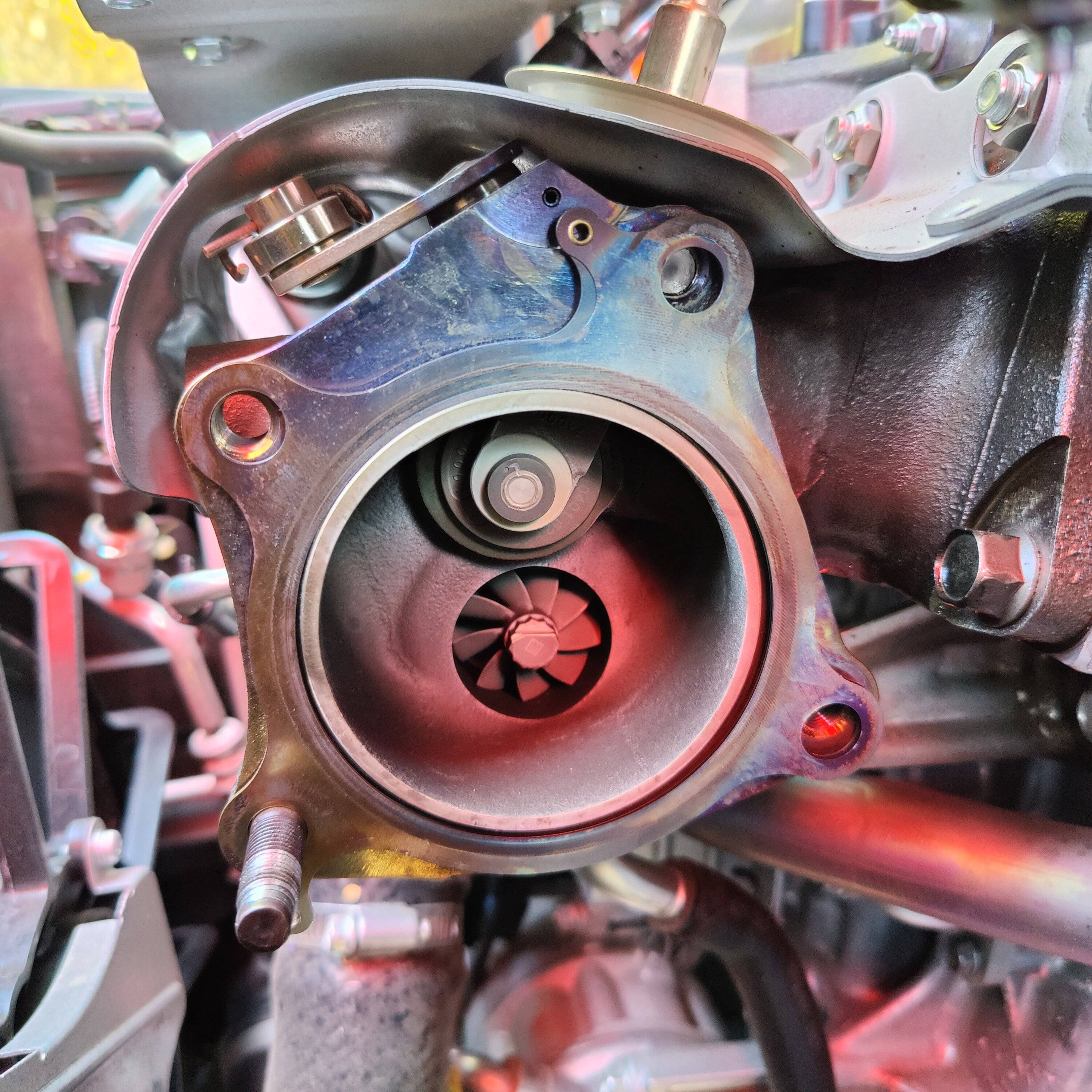

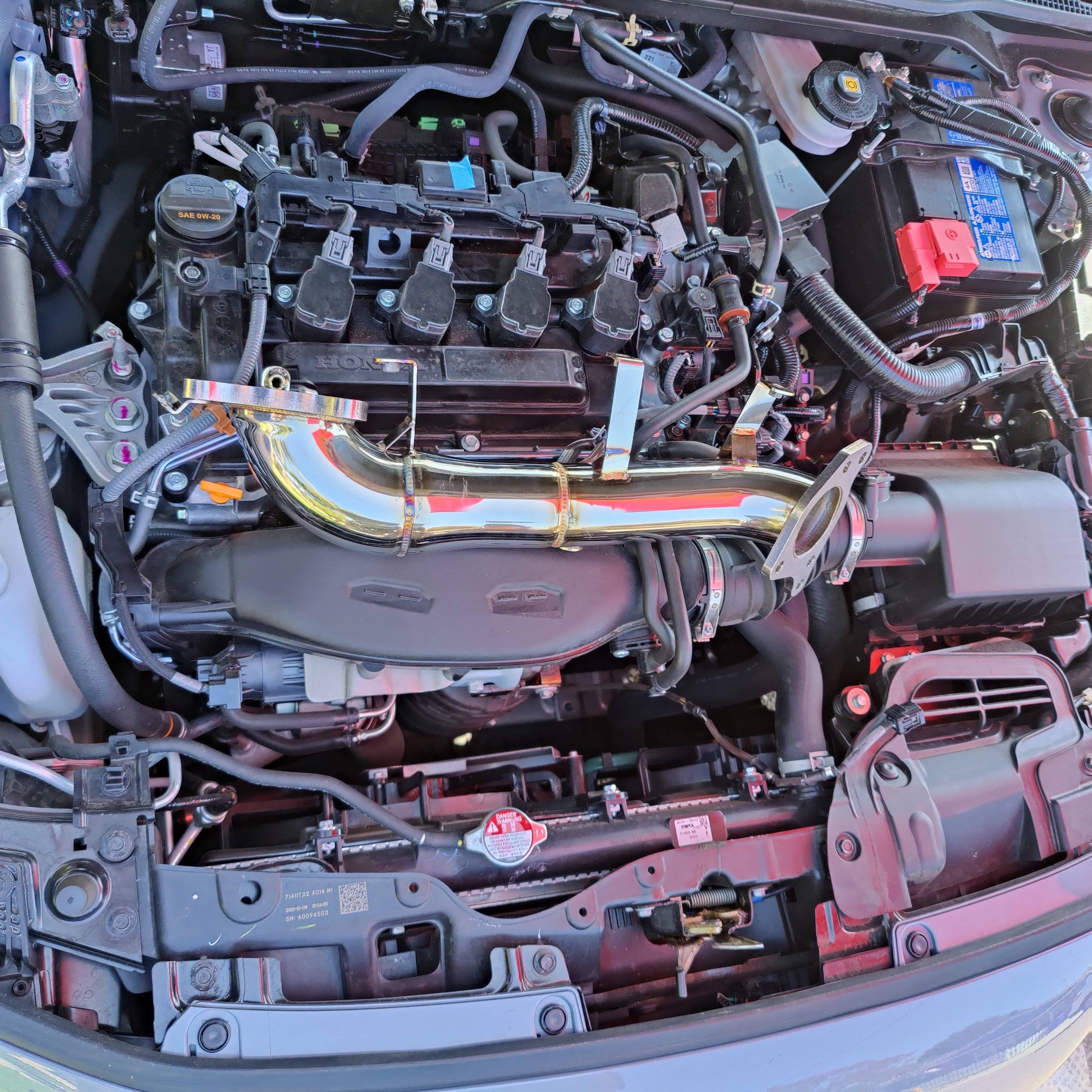

Recently given an opportunity to use/test/review/keep a 3" catless downpipe for the 11th gen civic.
First thoughts. I was mad excited, I mean who wouldn't be. Instal was pretty straight forward. It was pretty easy. Besides breaking the top right turbo bolt. Easy fix. Instal was about an hour tops, including fixing the broken bolt.
I have a pre production dual catback, so it's honestly not loud at all. It is definitely deeper. Sounds way louder inside the car than it actually is. Can definitely tell it pulls harder after 3k.
Faint turbo-whistle sound.
The pops/crackles, are mad annoying.i have a 6spd. If you shift under/around 3-4k you're gonna get hella bangs. Full throttle sounds really good, and you get a sweet sound when shifting. If you're driving, and let off the gas at around 4k, when it goes down to about 3 you will get a LOUD pop. Almost like a firework.
I made the mistake of removing my resonator on my catback way before I had the downpipe. So It was mad raspy in some parts, started around 3k. Goes away, comes back around 4-4.5. typical Honda rasp sound.
I ran untuned, had no CEL.(defouler)
I don't think these will be available, or sold. Something about EPA. Below is a small sound clip I've posted to YouTube. I'm sorry, I'm not the best video person.

11th Gen Honda Civic Catless downpipe review/test on 1.5T Civic Sport Touring IMG20220701095758
11th Gen Honda Civic Catless downpipe review/test on 1.5T Civic Sport Touring IMG20220701105050
