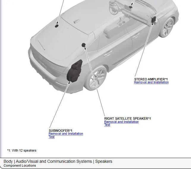

Does anyone have any more info on this? Looking for where the speakers are placed and sizes. I tried to look around and couldnt find anything.

Here's what I found. It's all about the sedan but I believe the only difference between the two is the hatch will have the twiddlers behind the headrests in the back and the sub is in the passenger rear corner
Bose Premium Sound System Details:
-One 3.25-inch (80 mm) Bose Twiddler mid/high-range speaker in the center of the instrument panel.
-Four 1-inch (25 mm) lightweight neodymium tweeters – one in each A-pillar and one in each rear door.
-Two 6.5-inch (165 mm) wide-range speakers – one in each front door.
-Two 5.25-inch (130 mm) wide-range speakers – one in each rear door.
-Two 3.25-inch (80 mm) Bose Twiddler mid/high-range speakers – one on each side of the rear deck.
-One 8-inch (200 mm) woofer in the center of the rear deck.
A Bose digital amplifier with 12 channels of custom equalization and advanced digital signal processing

The sedan has the Subwoofer in the rear deck, whereas the hatchback has the Sub inside the rear quarter panel as shown.
This looks like photo from the service manual! If true, how can I find a copy?
Wanna investigate the infotainment of the new Civic.
Anyone can buy a subscription at techinfo.honda.com
