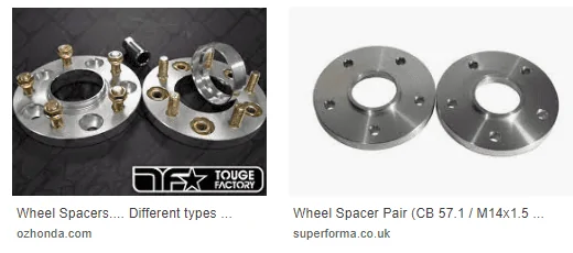

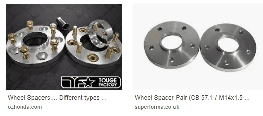

There are two types of wheel spacers, bolt-on and slip on (seen below).
11th Gen Honda Civic Big Brake Kit Installed on Si - problem with wheel bolts ?temp_hash=bed6eee493559a55dbbf361451768272
You most likely have slip on 5mm spacers. Once you go up to 15+ mm, they tend to be the bolt-on wheel spacers which use nuts to hold onto the factory studs and use their own studs to attach the wheel. View attachment 178238
