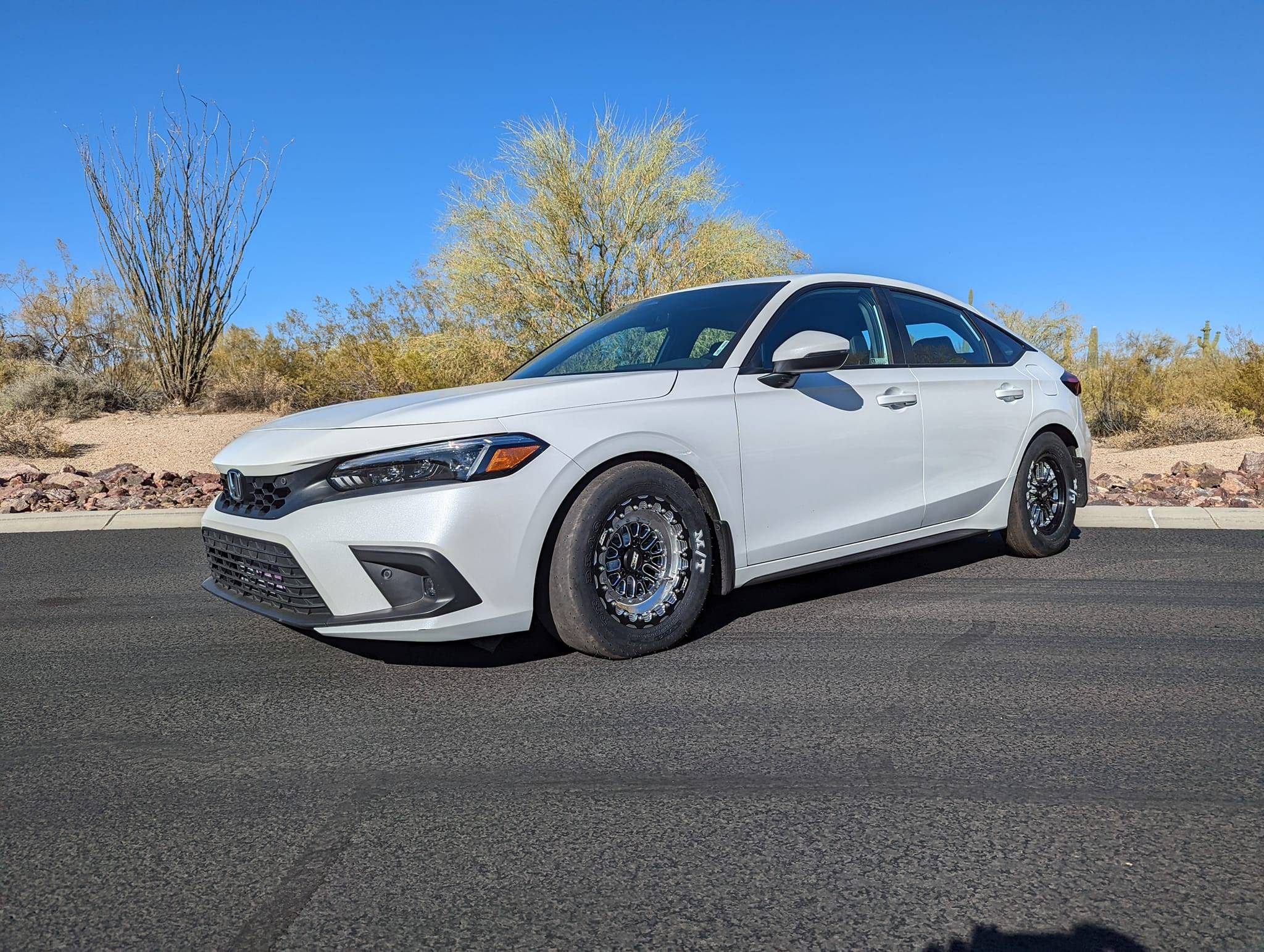

Hey guys
Wanted to show you the setup for our 11th gen Hatch build
Running Belak 15x8.5 front with 24.5" x 8" slicks and 15x3.5" rear setup 26" tire. Everything fits perfect on the car, just had to grind the rear caliper down a little as it was touching the spokes in the rear.
