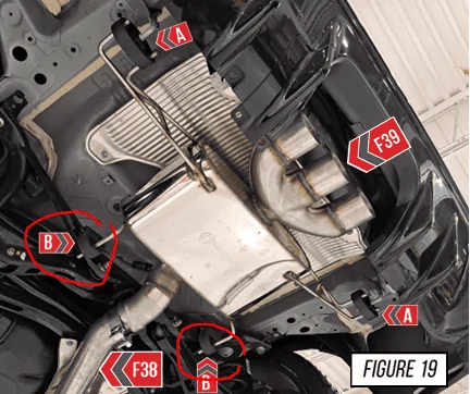

I have the AWE Touring but just looking at your setup, it looks very far back. Check under the car and look at the rubber bushings that the hangers on the muffler slide into. They should be sticking out about 1/4-1/2" towards the engine. If it's any less than that, you likely need to bottom-out all sections of the exhaust.
I had an annoying rattle for months (not nearly as bad as yours) and it would only happen at low RPMs in high gears. Turns out the muffler was barely hanging in the bushings (there were multiple times both hangers slipped out of the bushings and were just free-falling). Had to loosen all the clamps and force the pipes as far forward as they would go. Apparently this is a pretty common issue with slip-fit exhausts.

11th Gen Honda Civic AWE Track rattle IMG_0158
This is a Touring exhaust so yours won’t use the bushings labeled B but make sure the ones labeled A aren’t sticking through too far. If they are you probably have the exhaust too far back.
It’s likely either hitting the heat shield or the subframe (near the clamp by F38 in the pic above).
