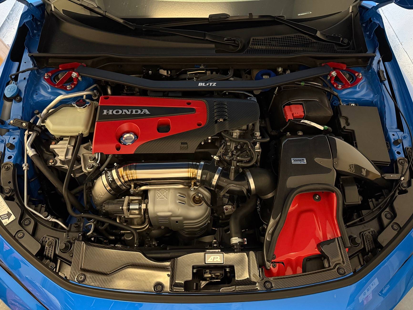

Searched and couldn’t find any info on it, but it seems if you run an intake with the APR carbon cooling shroud piece you’ll have to do some trimming.
Is anyone running an intake with the APR shroud that didn’t have to modify anything? I don’t mind modifying if I need to, just trying to see if I can avoid it.
Leaning towards the Gruppe M / Blitz, but not opposed to other brands. Not looking to replace the inlet pipe, just a clean looking intake setup.

It was designed for use with the factory airbox. We highly encouraged fitment options for popular aftermarket options but it never happened. :(

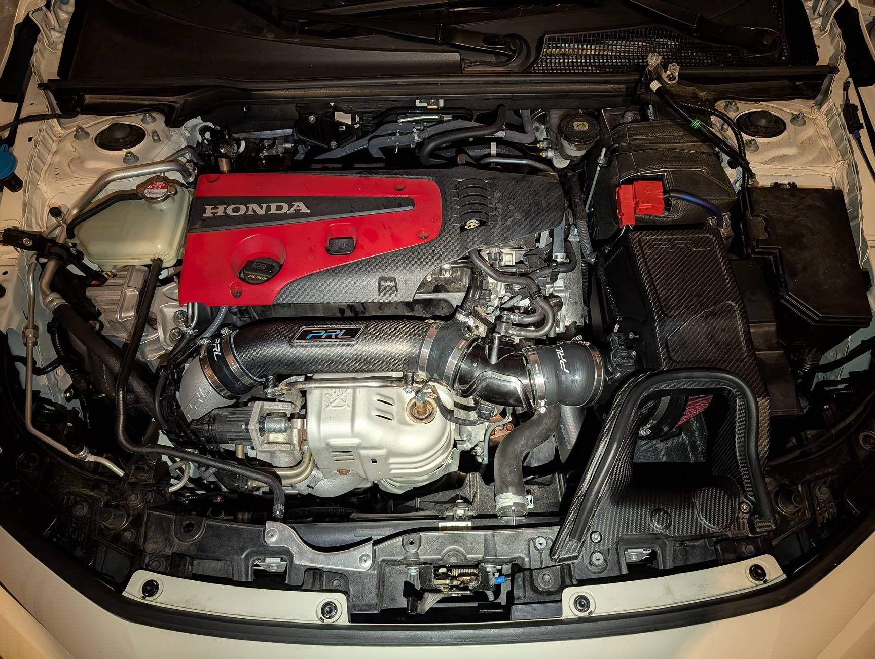

I have the apr cooling carbon plate and running the gruppe m intake. There is no modifications required and it fits fine.
Would you happen to have any pics?
Have you had any issues with the Intake? I’ve seen on social media people saying they have issues with the elbow or clamps?

I haven’t had issues with it. I really like the intake so far.
