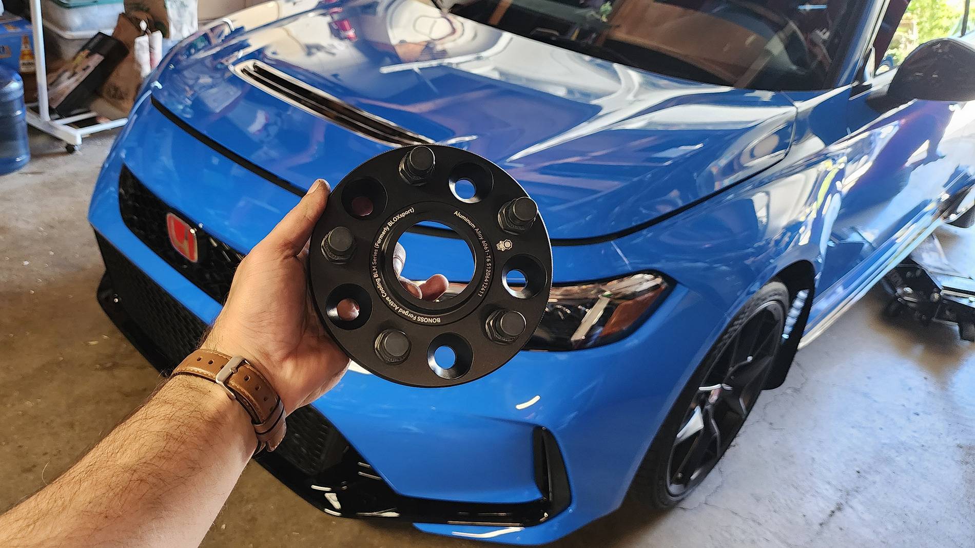

I recently installed Spoon Progressive springs along with Bonoss spacers, 25mm x 20mm.
Just wanted to share an install vid that shows the final configuration.
Install was pretty straight forward:
-spray with brake cleaner
-add a drop of blue threadlock to the OEM studs
-place the spacer
-transfer the spacer nuts to the OEM studs
-torque all nuts to spec (94 ft lbs / 127 Nm)

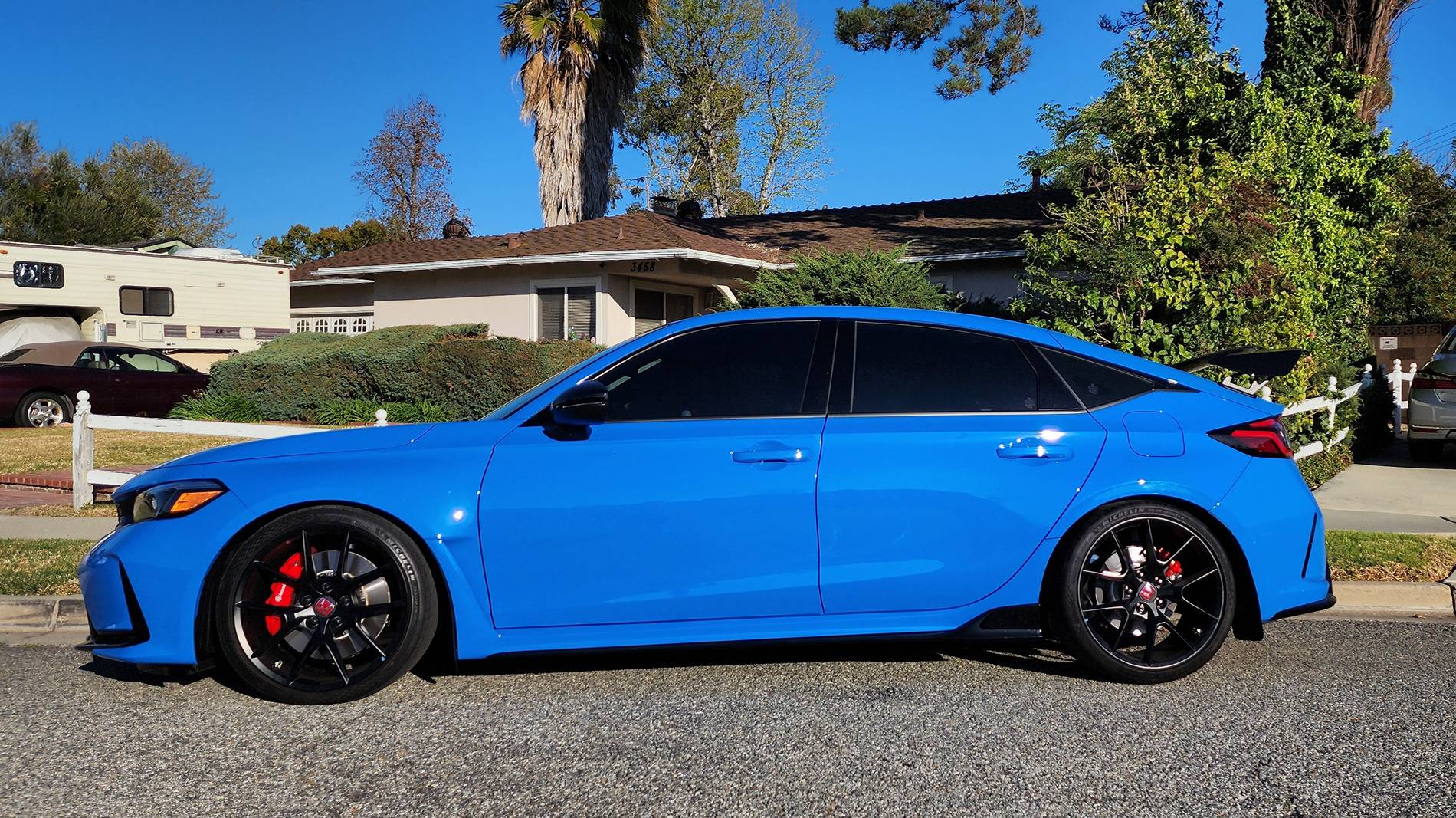

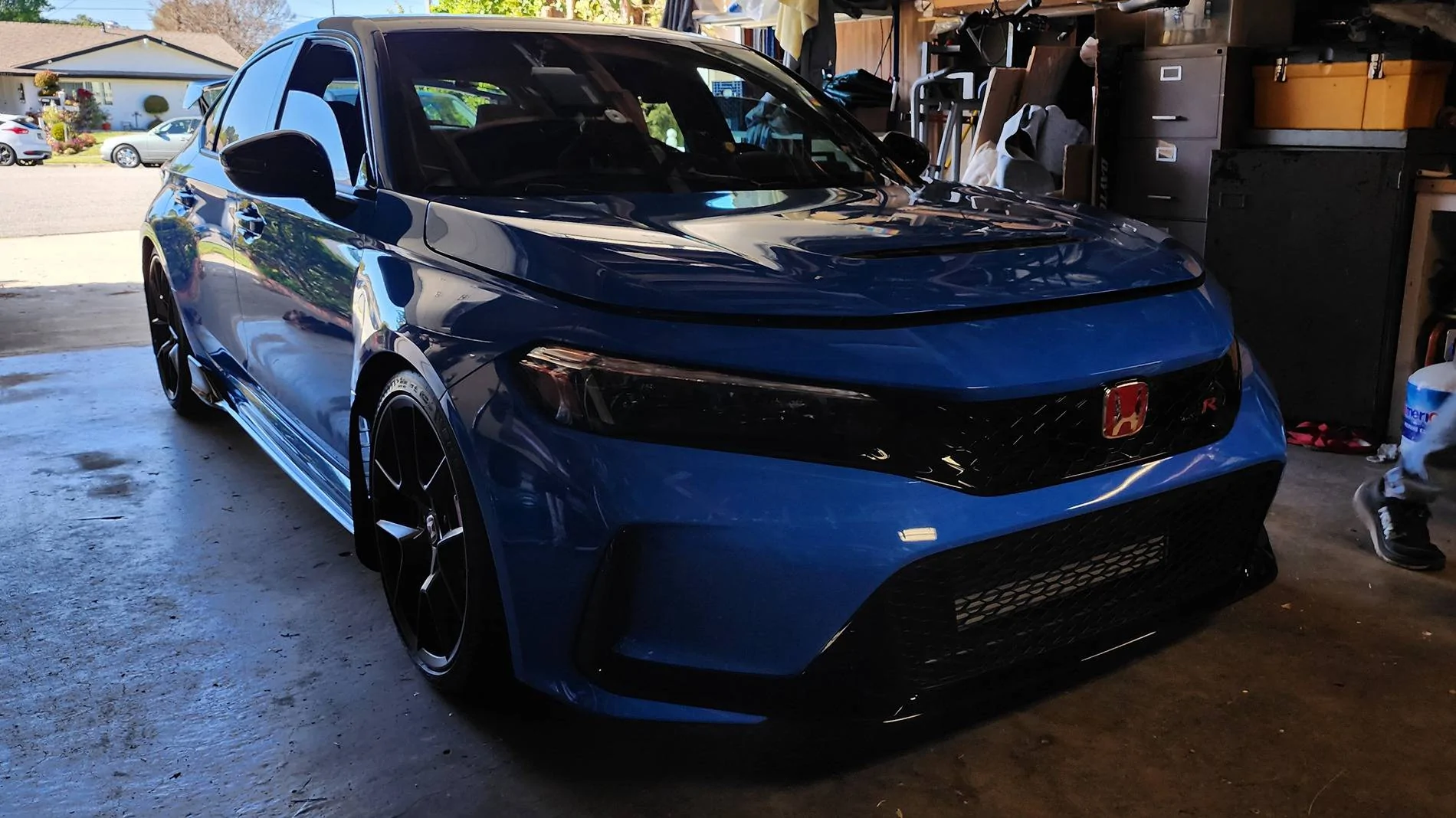

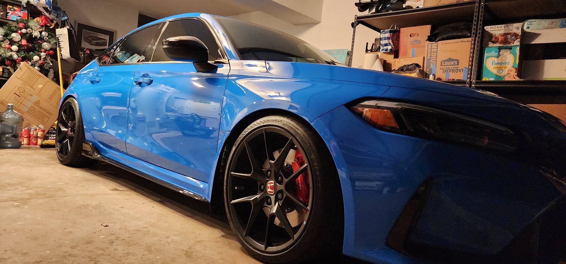

Before:
11th Gen Honda Civic 25mm x 20mm Bonoss Spacers Install Video and Pics 2025-03-09 16.00.42
11th Gen Honda Civic 25mm x 20mm Bonoss Spacers Install Video and Pics 2025-03-09 15.55.15
11th Gen Honda Civic 25mm x 20mm Bonoss Spacers Install Video and Pics 2025-03-09 15.55.11-1
11th Gen Honda Civic 25mm x 20mm Bonoss Spacers Install Video and Pics 2025-03-09 14.23.08
11th Gen Honda Civic 25mm x 20mm Bonoss Spacers Install Video and Pics 2025-03-09 14.17.04

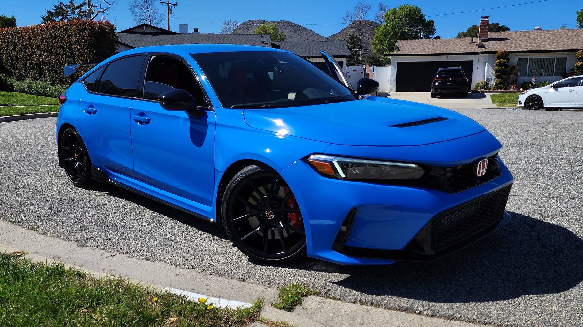

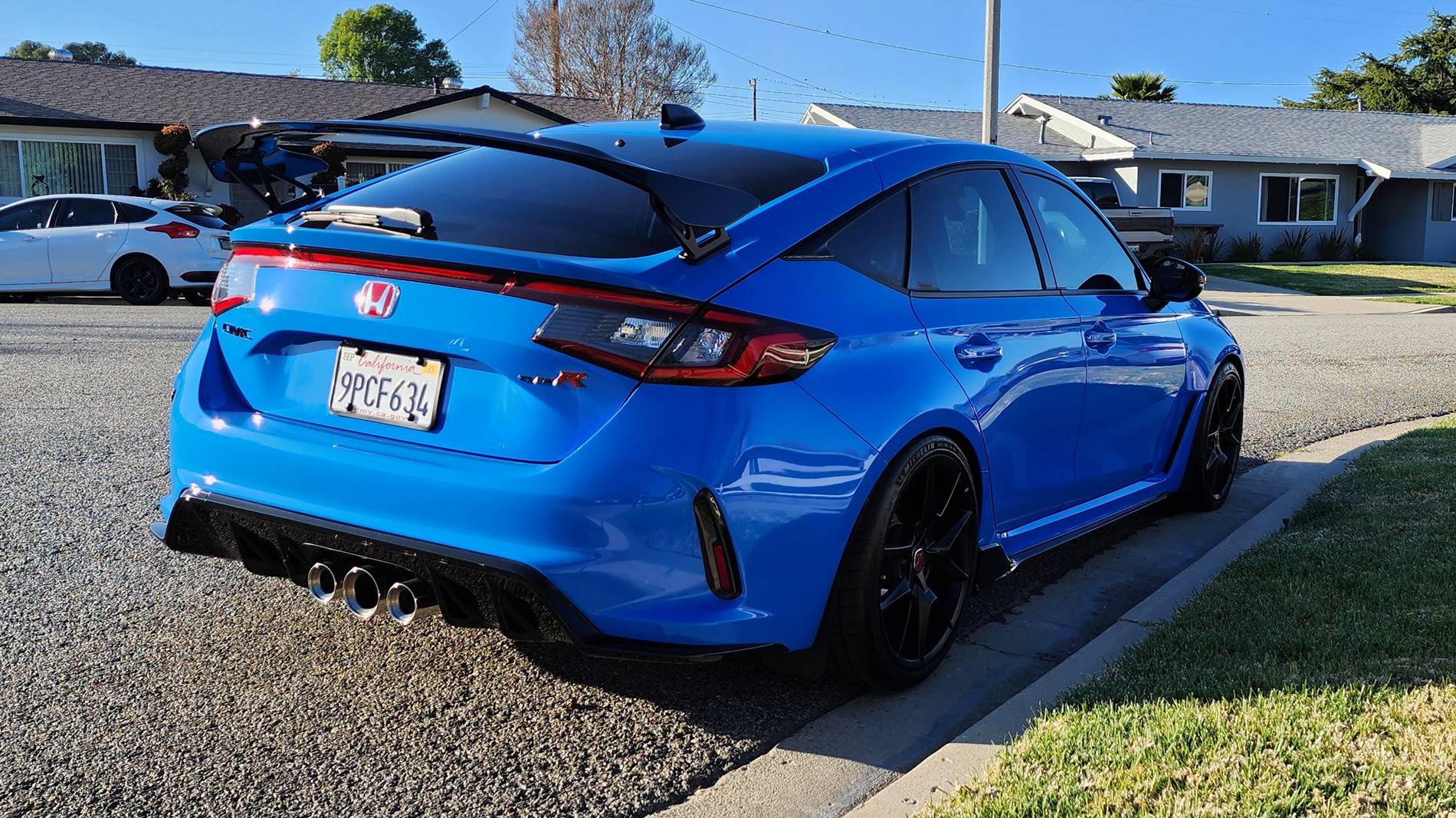

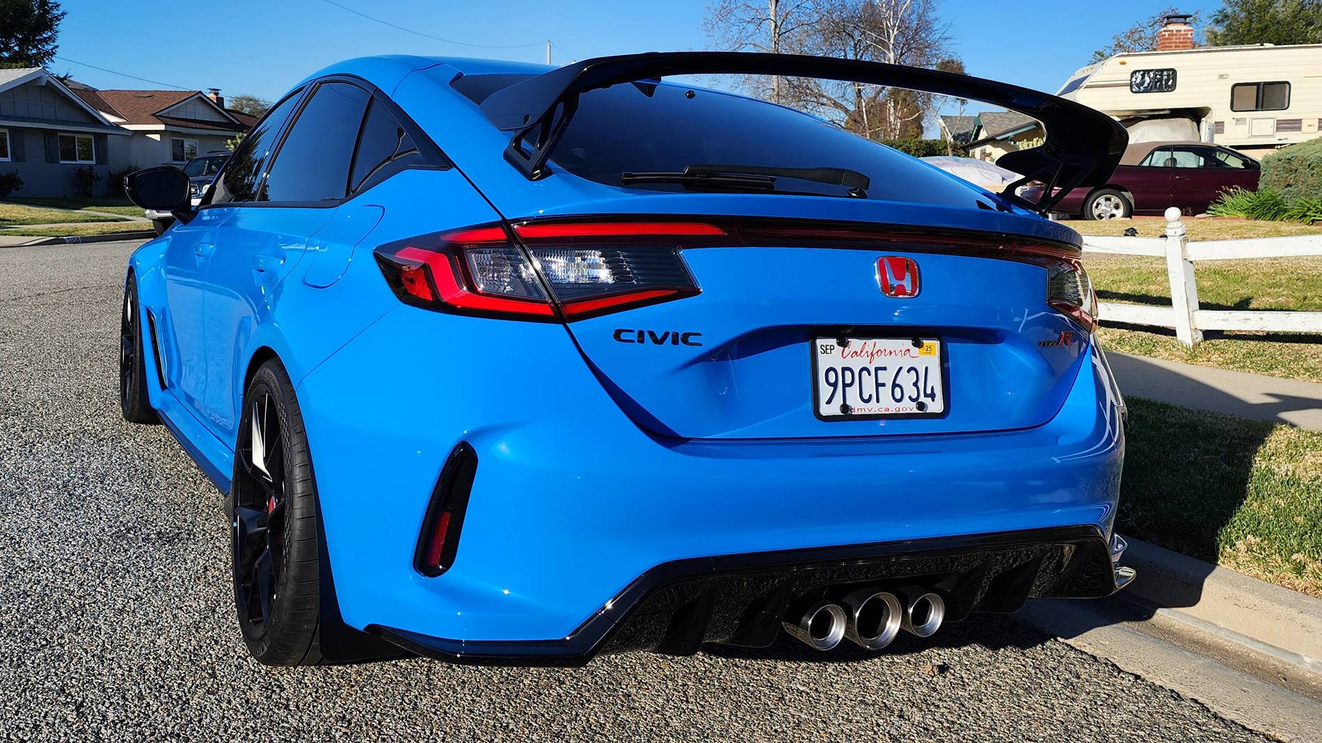

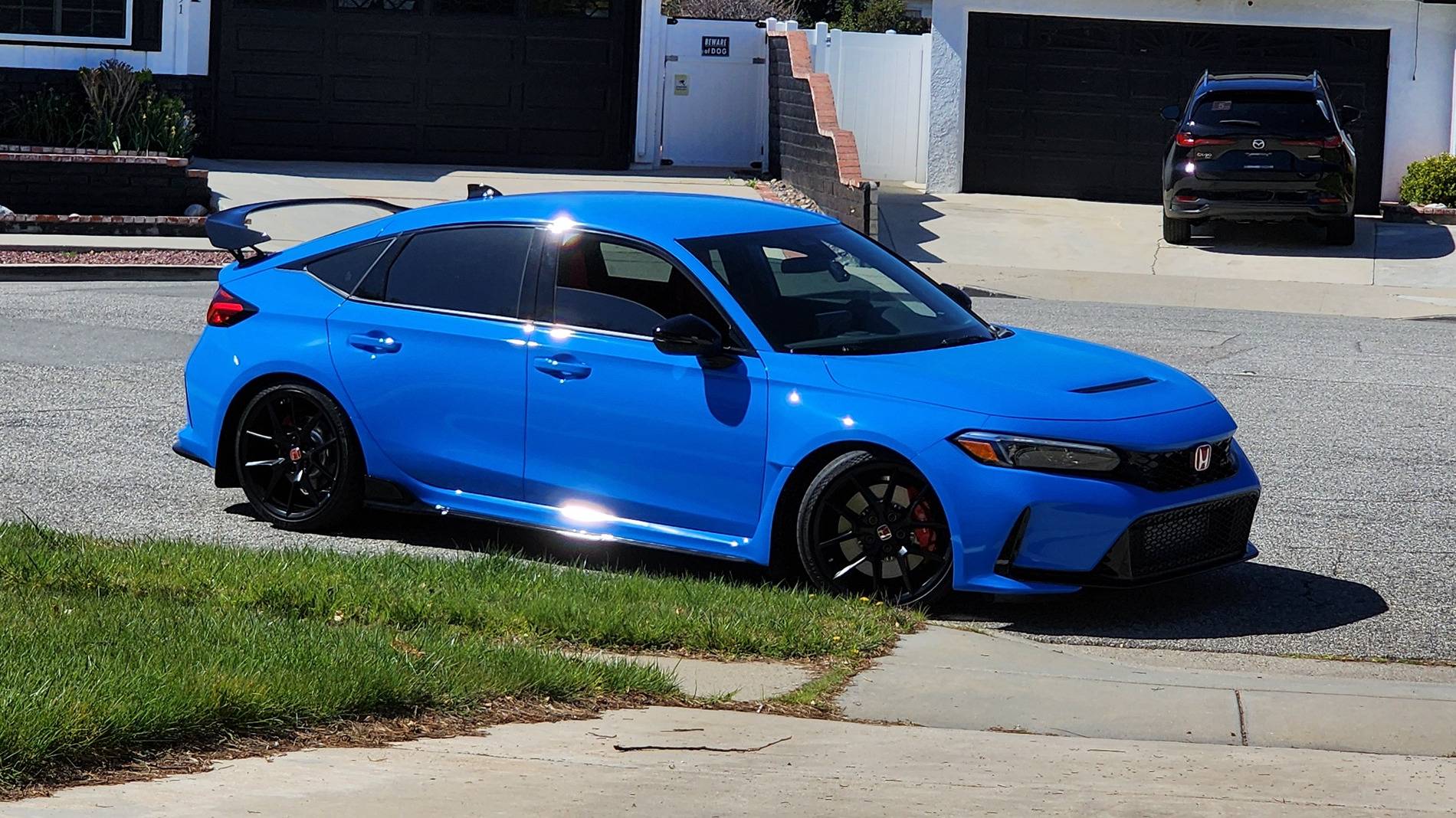

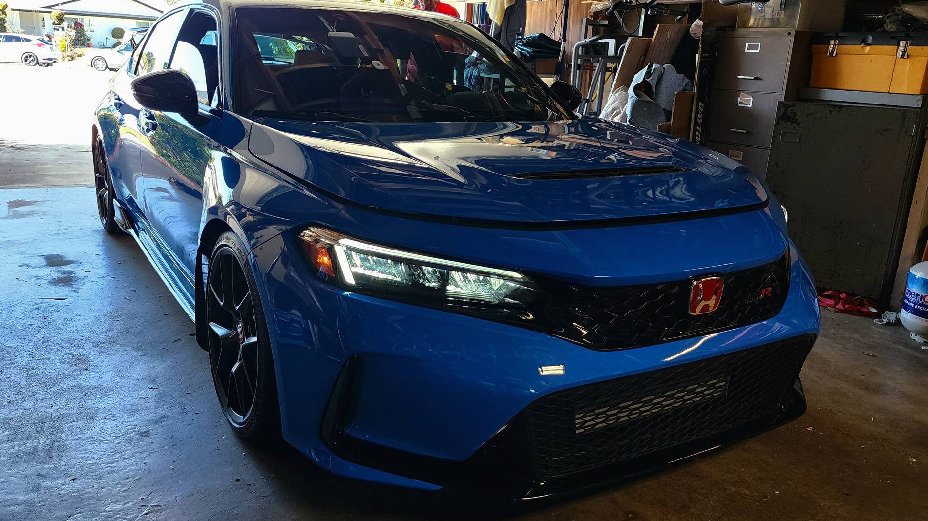

After:
11th Gen Honda Civic 25mm x 20mm Bonoss Spacers Install Video and Pics 2025-03-09 17.28.38
11th Gen Honda Civic 25mm x 20mm Bonoss Spacers Install Video and Pics 2025-03-09 17.28.58
11th Gen Honda Civic 25mm x 20mm Bonoss Spacers Install Video and Pics 2025-03-09 17.29.29
11th Gen Honda Civic 25mm x 20mm Bonoss Spacers Install Video and Pics 2025-03-09 17.28.46
11th Gen Honda Civic 25mm x 20mm Bonoss Spacers Install Video and Pics 2025-03-09 21.28.19
11th Gen Honda Civic 25mm x 20mm Bonoss Spacers Install Video and Pics 2025-03-09 21.27.52
11th Gen Honda Civic 25mm x 20mm Bonoss Spacers Install Video and Pics 2025-03-09 21.28.02
