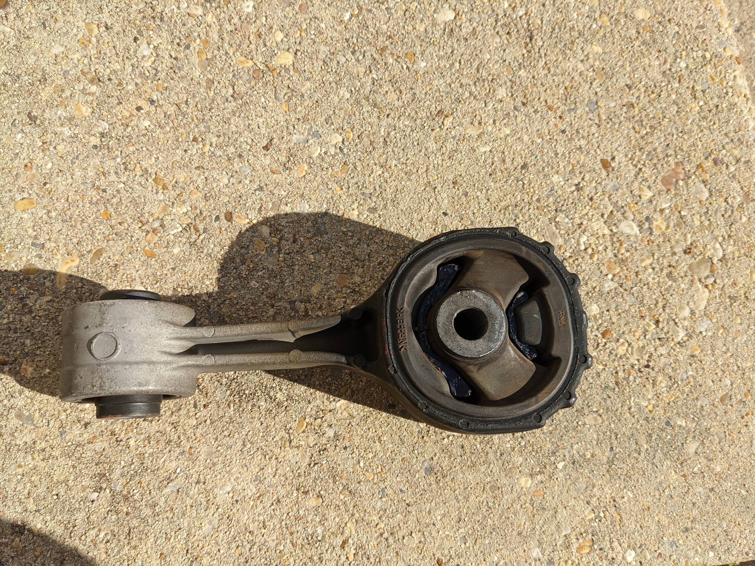

On an educated guess, I bought myself a Whiteline RMM insert for a 10th gen Civic and tried to fit it into my 11th gen Si. It went in perfectly without issue, but doesn't completely fill in all the voids in the 11th gen mount. If anything it might make the mount feel a little less vibey.

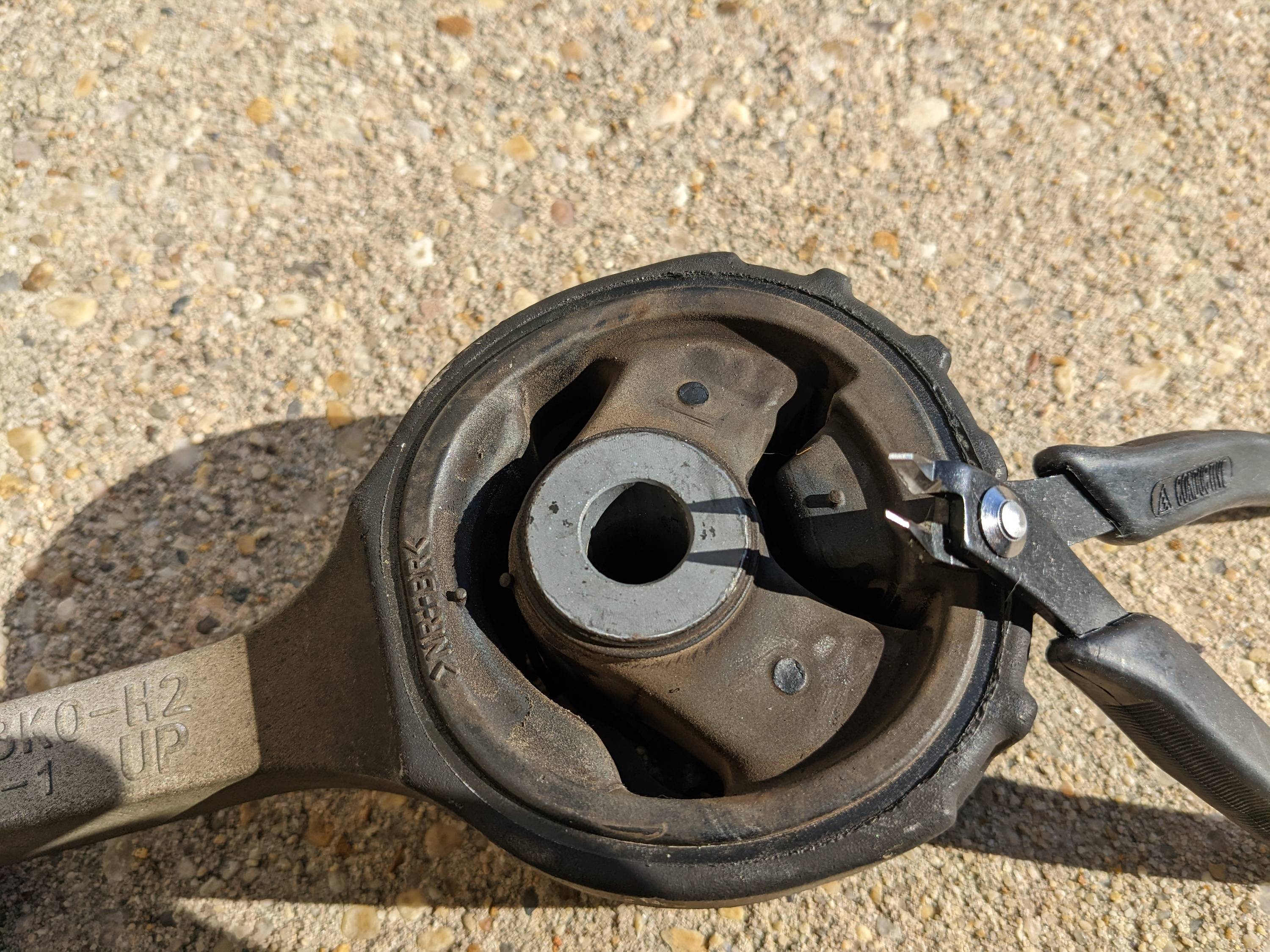

Clipped the nipples one the OEM rubber.

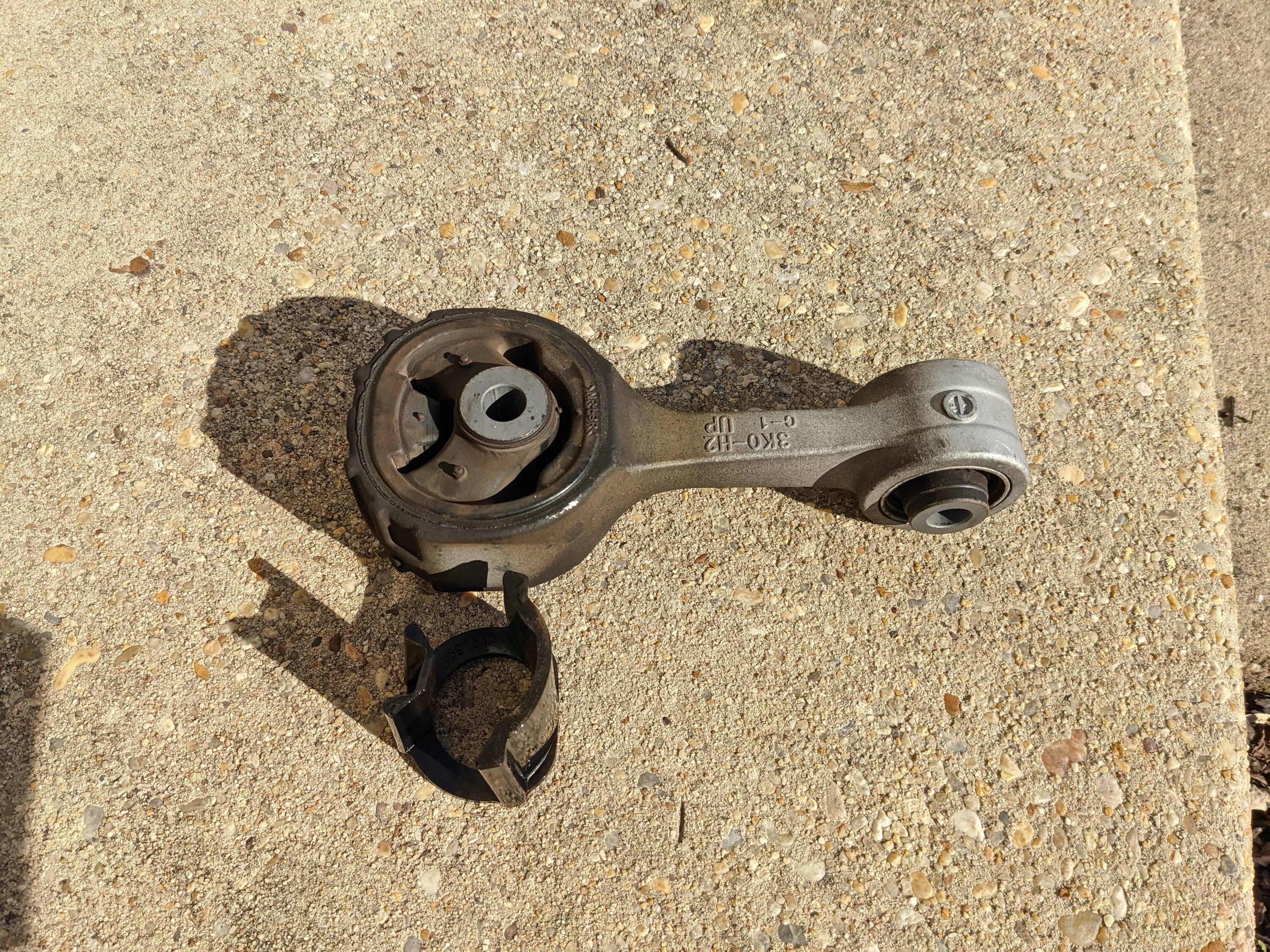

Top side.
11th Gen Honda Civic 10th Gen Whiteline RMM insert installed in 11th Gen Si. Gzzh1Xa
Bottom side.
11th Gen Honda Civic 10th Gen Whiteline RMM insert installed in 11th Gen Si. wsiONWo

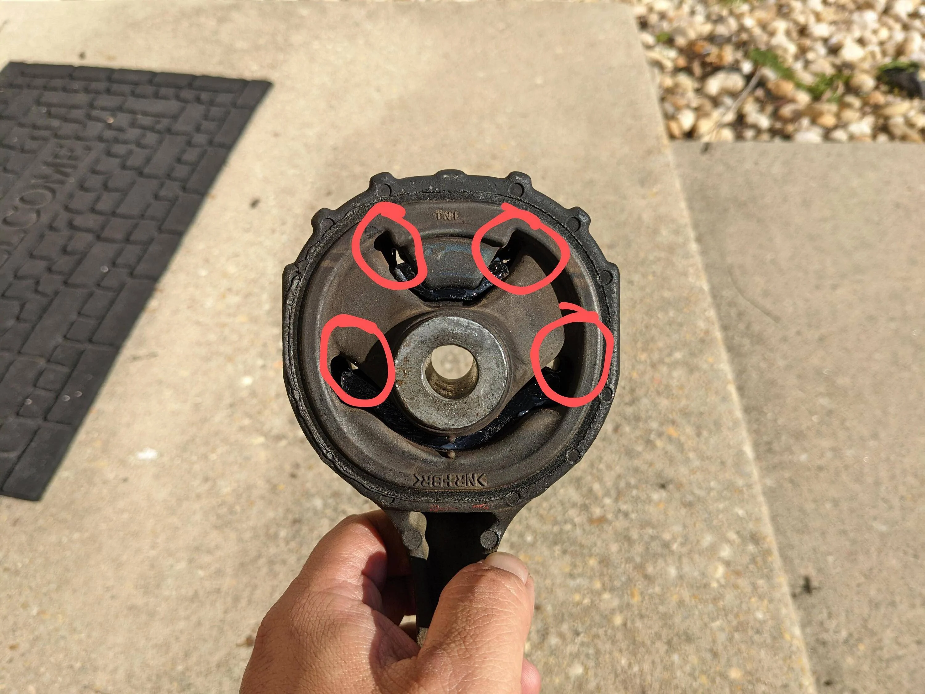

Circled the areas that don't get filled by the mount.
